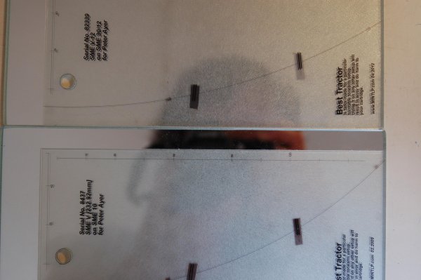

Here is a photo showing the relative curves traced by my 9" SME V and 12" SME V-12 arms on the Mint protractors. Note how much flatter the 12" curve is and the overhang distance from the spindle hole.
Very informative pictures, thanks Peter.
