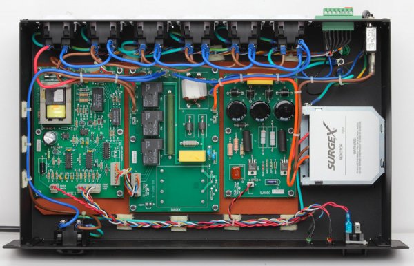

Occam which 100uH inductor? Is it within the box itself? I believe SurgeX sells their unit with one PCB board, and I don't recall "a" inductor on the board. Here's a photo, the board on the right is included with their OEM set I believe.
