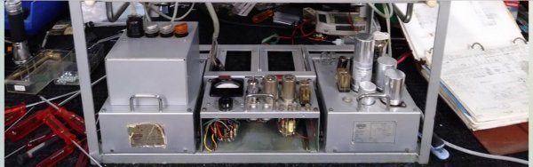

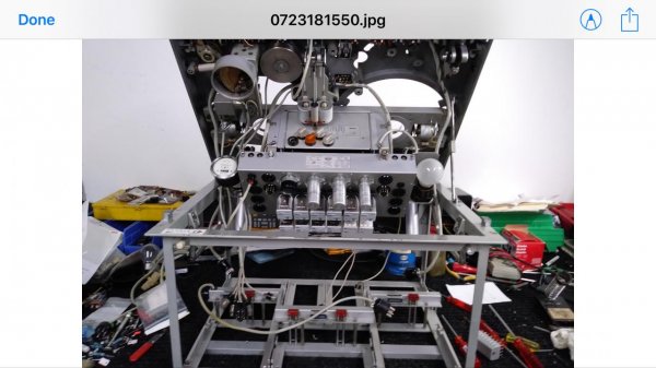

I’m almost ashamed how long it’s taken to restore this super rare deck. The tech is again working on it and I hope to have it before the winter. Gotham Audio imported 6 of these American voltage C37’s. Here is a new photo sent today..I have my fingers crossed.

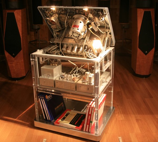

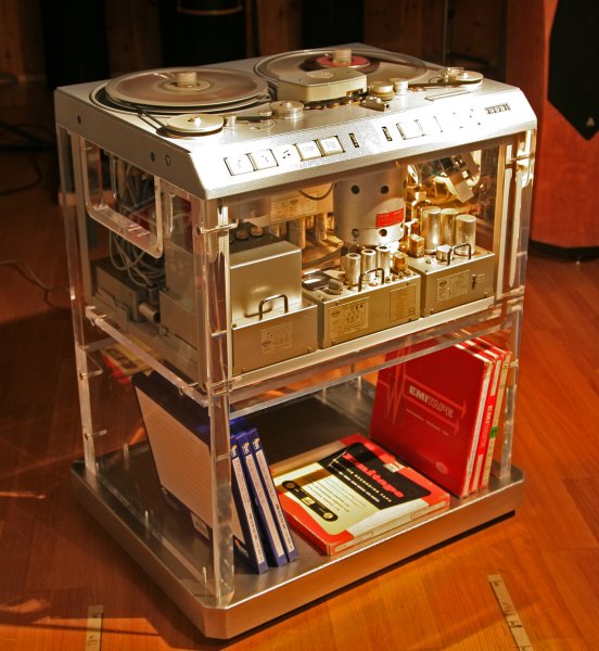

This was mine i bought in 2011 with plexiglass rack made by www.therecorderman.com,completely restored in italy and part in Germany from 2 old studer technician
I had also,A 80 and the difference between them from my test is like to listen a good solid state ( A80) and Ongaku ( C37 ),same difference,i had 2 Ongaku so i know well.
Then i sold in 2016 C 37 to go on on my system and i kept A80 because the value is less
Therecorderman sell the plexiglass rack for C 37 that is very good

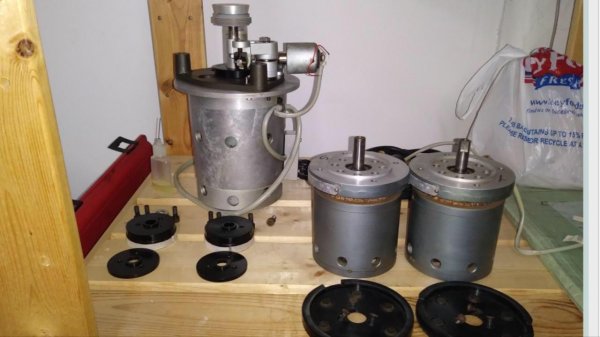

Here are the capstan & reel motors all cleaned and rebuilt. Service tech Dan Zellman says he will have it finished this weekend. DE4C8AA2-2BAA-4DBF-AD9B-E25DD645867E.jpg 3126FC9C-04E1-4E43-B956-8A18C2493E9D.jpg 29F38195-4FB2-4219-B05D-8139F6295C45.jpg

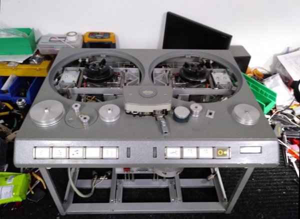

Studer C37 coming along soon to be done. I am jumping for joy! View attachment 43386
Right side switch cleaned and repaired.

The switching is done completely rebuilt.Now the painting of the turntable platters,testing capstan & real motors , headstack , & final alignment. Then touch up. It has been a long arduous journey.

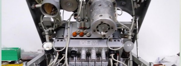

Here's a new one today.Electronics recapped and rebuilt, tubes & new relays replaced that were needed.

The "GOTHAM C37" is finally nearing a complete restoration .Should be a week or two away.You can see from the original pictures it was in need of paint and a good cleaning . I decided to restore the deck mechanically with new running parts ect, with recapped audio , power supply, rectifier, solenoids & tubes . Everything was cleaned along switches rebuilt new bearings for motors cleaned. Correct 5&7 class bearing in the running gear.New Brake assemblies including linings.Studer A80 Dark grey was used to paint the turntable platters.I am very happy now all we need is to get this home from New York City.
