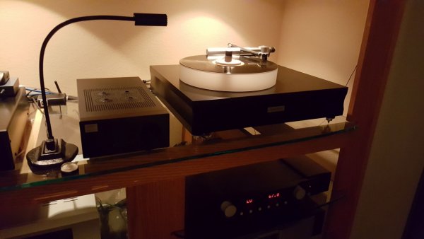

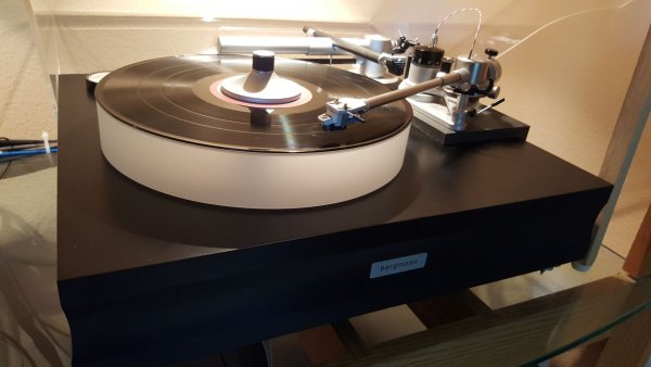

rI previously owned a Goldmund Studio with their latest linear arm (T3 or T4?) which was servo driven by detecting any deviation in angular position. Their solution addressed a problem of relatively high mass in the horizontal direction as seen at the stylus tip, by allowing for a slight horizontal pivoted movement and using a DC motor to move the arm sideways as needed. Unfortunately it only incremented in one direction leaving some error for eccentric center holes. That said, I liked the sound and function and was immediately drawn to the engineering elegance of the Bergmann arms.
I replaced the Goldmund with a Bergmann Sindre which performed beautifully where the Goldmund was lacking. Much more rigid, the arm provided a solidity of image and beautiful lack of distortion on the innermost grooves that can't be touched by any radial arm since they are all plagued by anti-skating related issues. I've some experience with the new Odin which takes the rigidity of the arm to a higher level and seems to be less sensitive to variations in air-flow volume and is better able to handle heavier cartridges. The Odin also improves on the cueing mechanism over the Sindre arm. The former being direct and consistent, the latter a bit touchy with it's o-ring connection. On the fly VTA adjustment (if you're into that) isn't really practical with Bergman arms. I've also found that the Bergmann tables are completely insensitive to any sort of mechanical feedback. For extra fun I fabricated a "C" clamp arm-board to allow me to mount a VPI arm so that I could easily add and swap different cartridges easily. For context, I've included a photo of the Goldmund 20170818_094148.jpg 20160714_213053_scaled.jpg 20160622_110018_001.jpg
