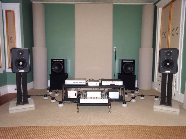

Reference 3A Reflector monitors in my system

As for equipment supporting this review, obviously source and amp must be of sufficient quality to allow uncovering the capabilities of the speakers. My source is CD replay from a quality transport through the highly regarded and highly resolving Schiit Yggdrasil DAC. Do not get fooled by its rather low price, it is the flagship design of Mike Moffat, a digital pioneer of Theta Digital fame. I have heard the Yggdrasil DAC in a number of direct comparisons with a multiple times more expensive, quite famous DAC in a superb system. In these contests it fared exceptionally well. Several reviews have also found that the quality of the Yggdrasil DAC compares favorably with DACs costing multiple times as much. I use an Octave RE 320 tube amplifier (with Super Black Box) that delivers an astonishing performance. The cabling by ZenWave Audio (owned by WBF member DaveC) is excellent. My full list of equipment can be viewed on my system thread, first post.
Getting the best out of the speakers also required rethinking and readjusting the acoustics of my room; some efforts in regard to that can be read on page 8 of my system thread. The transparent and emphatically ‘outspoken’ quality of the Reflector monitors brought to my attention acoustic problems of the room that were not as evident with the MM DeCapo BE monitors, which in comparison are more ‘forgiving’.
The Reflector speakers have played for half a year in my system, thus they are fully broken in. I had not listened to the MM DeCapo BE during this time. Just to make sure that these monitors would be at their best for the comparison, I performed a new ‘mini break in’, consisting of letting them play for two full days before serious evaluation. During the comparisons, the MM DeCapo BE clocked another substantial round of hours.
As for speaker set-up, the Reflector manual reads:
"An equilateral triangular positioning is recommended setting up Reflectors. Distance between the speakers, measured from the main driver's center, should be equal to the distance where the listening area is. Toeing them in until the inside front and rear edges of each speaker appear to be lined up is recommended if the space allows. If the room is narrow and long the speakers may be positioned closer together with slightly more toe-in angle (on axis). Reflectors' high frequency wave guide allows higher velocity wave propagation and the performance will still be very good on longer distance listening positions."
I took the above instructions on equilateral triangular positioning to mean equal distances between the centers of the main drivers (or between the centers of the tweeters, which is the same in this case), and ear to tweeter. The latter is a common way of measuring speaker distances; also, the tweeter is at ear height and measuring distance from the ear to the center of the main driver would mean measuring at a downward angle, thus a slightly longer distance. All the distances in the equilateral triangle are 8.4 feet in my room. Distances were measured with a laser measure (Bosch).
I made a drawing to reflect the speaker set-up as seen from above. The speakers are shown with tweeter embedded in its wave guide (c.f. image of speaker above):
From the listener's view, front and rear edges of the speakers line up. Until I had made the drawing I had not realized that, while the centers of the speakers are slightly off-axis when judged by the listener's eyes, they are more on-axis with the ears. The triangle in the drawing is measured to actually be equilateral on all sides according to the criteria described. When you sit in front of the system, however, the speakers seem much closer to you than they are apart from one another, which of course is an optical illusion.
Most recently though I modified the listening position somewhat, moving the listening chair back 6 inches. Even though I like to have a direct, immersive sound, I now prefer the slightly more distant perspective, which is still quite upfront (but also features great spatial depth where required, as did the configuration of equilateral triangle). In that listening position I continue to follow the manufacturer’s suggestion of toe-in so that inside front and rear edges of each speaker appear to be lined up. As a consequence this leads to a slight toe-out compared to the scenario with equilateral triangle, where like in that case the speakers are almost on-axis (the panoramic image of the current set-up of the whole system above, as captured by the camera, does not adequately portray the toe-in).
The MM DeCapo speakers were toed out to a greater extent, according to the manufacturer’s instructions. The distance of drivers to the listener’s ears was identical to that of the Reflector speakers.
