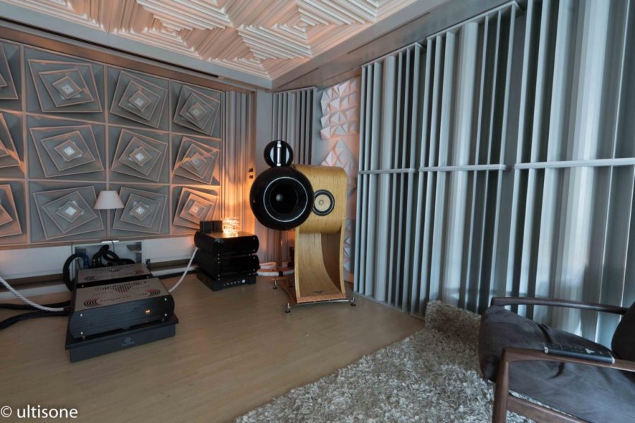

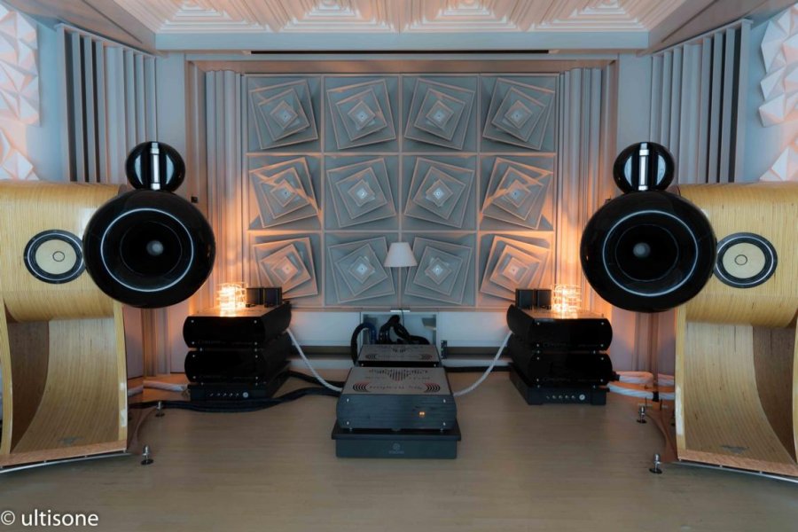

Would be interested to know who you are referring to. There are only 2 dedicated rooms in Taiwan using SMT diffusers and Helmholtz resonators, including mine.
Only 3 people heard my room:
- the Magico dealer in Singapore, who based on the listening experience with the Magico Q1 decided to rebuild his full show room with SMT treatment, and to distribute SMT in Singapore
- the other owner of a SMT room in Taiwan (I doubt he wouldn't like it)
- one of his friend who wants to invest in a SMT room.
As in any room treatment, there is a big part of science, but also some art... and luck. You never know how it will sound before building it. But in a game of probability, you have much higher chances to get a poor result with a lot of other room treatment specialist (from my experience hearing tons of rooms before building mine).
Sure, you can build a Helmholtz yourself. Saving would be very limited, much less than the money you spent in a single of your cables (rather build your cables yourself, saving will be higher!). I prefer the convenience and piece of mind of getting something which has been tested and work (and the opening in the diffuser is a bit more complex than an adjustable gap...).
Good luck on building Wings diffusers yourself. Their profile is not so straightforward. Assuming you would get all dimensions right, I doubt you would save any money.
SMT wings diffusers are very unique, because they are the only one who work in the near field (unlike normal quadratic diffusers, they are not only spatial diffusers, they are also temporal diffusers). If you have a 17x 10meters, you can live with a RPG diffuser.... as they would work well if you sit more than 3-4meters from them. In a smaller room like mine, I can sit 60cm from the back wall without any problem. See the measurements of my room and a bit more explanation in the thread "new home for my magico Q1"
