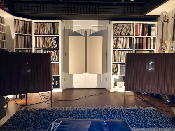

CE273A99-5FAF-4D0D-A295-2DFA1F384981.jpg Since buying restored 57s from Electrostatic Solutions a year ago I’ve somewhat compulsively looked for speakers that can better them but in my smallish room I haven’t been able to. Maybe it’s my less than perfect basement listening room that the QUADs happen to excel in, or my inability (maybe more my disinterest) to spend $15k+ on speakers, but I’m questioning how much better it can get (again, in my imperfect listening room). Partly it may be an unwillingness to except that a 60 year old design can be so advanced, but I’m pretty sure I’m done until something comes along and proves itself to be definitively better. Enjoy your new purchase!

View attachment 43725 Since buying restored 57s from Electrostatic Solutions a year ago I’ve somewhat compulsively looked for speakers that can better them but in my smallish room I haven’t been able to. Maybe it’s my less than perfect basement listening room that the QUADs happen to excel in, or my inability (maybe more my disinterest) to spend $15k+ on speakers, but I’m questioning how much better it can get (again, in my imperfect listening room). Partly it may be an unwillingness to except that a 60 year old design can be so advanced, but I’m pretty sure I’m done until something comes along and proves itself to be definitively better. Enjoy your new purchase!
I find your room and system really appealing. What amps and source are you using?
Great stuff.
Thank you! I’ve tried a few amps but my favorite have been some custom Blue Circle. Sources: mostly vinyl, Kuzma Stabi M, Thorens TD-124, Garrard 301. For digital I have a Resolution Audio Cantata.
Dipole panels work really well in small rooms (My Acoustats, STAX, Apogee and Audiostatic all attest to this). Christoph also has Acoustat in a small room (as his like tenth system :rolleyes:) that works VERY well indeed. It may well be that few speakers will work as well in a smallish space as a pair of Quads.
Yes that could be so, which is why I emphasized my small, relatively untreated room. I certainly imagine there’s better, but nothing I’ve tried is.
