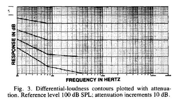

They offered curves with different amounts of bass. None of which worked for my sensibilities. My target in the bass looks more like Harman's Synthesis or Holman's -30 dB curve from his "Loudness Compensation: Use and Abuse." Figure 3 as attached.
The black line above is the Synthesis, the red line is me fooling around.

Any concern with your red curve overdriving the subs?
It not only overdrove the subs at higher levels, but exposed low frequency junk on movies and music recordings that seemed unintended at best, so I toned it down. The Harman curve is much more practical.
I visited RUR's system over the weekend and subjected him to that curve, using the 1/3d octave EQs in the ST-2. Naturally I liked it, but the jury is still out from Ken's perspective. It's something one has to live with for a while after running "flat".
