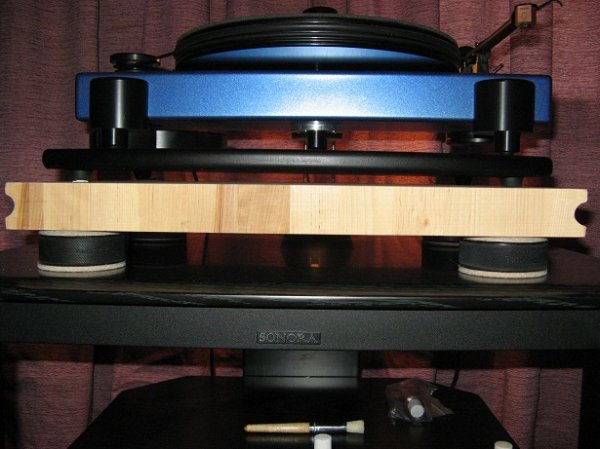

I currently use a Mana Reference table under my trampolin-less lp12. I will eventually go to stage 2 of Mana, but I think people would be suprised at how good Mapleshade's 2-inch maple with their rubber/cork/rubber footers sounds.
Johnny Vinyl
May 16, 2010
8,570
51
38
Calgary, AB
Or how about this for less than $25:
Butcher Block
Hockey Pucks (4)
Furniture Felt Pads (8)
Johnny Vinyl

That Ikea butcher's block is probably the best value in hifi! I have so many that I've lost count. One thing you may like to try is to use just 3 pucks - one directly under the motor, one near the front, and the other on the side under the arm. Just an idea - because asymmetric loading will throw out more resonances. If the pucks make a triangle, try to make the three sides of the triangle different lengths.
