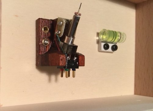

The Van den Hul African Grenadille Stradivarius is now playing, after a short panic moment - no sound on the left, because the van den hul pins are thinner than those of the Kiseki and were loose. Fortunately I had felt they were entering too easily ...
Great dynamics, I picked the spectacular Paniagua Villancicos (Harmonia Mundi) for the first listening. Rhythm is fabulous, bass seems lighter than Sumiko Palo Santos, explosive percussion in a large soundstage. But still a few hundred hours of burn-in to go without auto repeat...
Can I ask what settings are SME 3012r owners using for antiskating with these Colibri's?
congrats! great cart! enjoy.
one thing - those are ultra delicate set up wise cartridges, and i talk from experience. the more you fiddle to the end, the more you get from those fighter plain carts!
i advise you to get the analogmagik software and lp's and get a precise set up. you would thank me greatly in the end!
best of luck.

Antiskating on vdh Colibri should be mostly in the range of 30% of the choosen tracking force, so on SME 3012r my starting point was 0,5
very important is the interaction of tracking force and Tonarme height. If you change one of this parameter, the other should be adjusted accordingly too.
