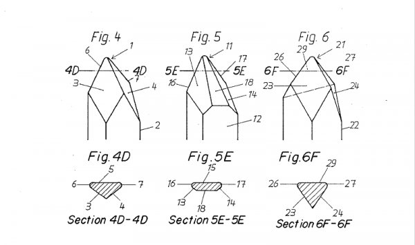

I am quite certain the Replicant 100 stylus is a variation of the Fritz Gyger stylus, with [major/minor radii] R/r 100/5 microns (hence the name), instead of the typical 80 (wasn't there a Replicant 80 before???). US patent US4855989 (pdf) is a translation of the original European and makes the following claims:
1. A stylus for tracking stereophonic and quadrophonic sound grooves of gramophone records, comprising:
a stylus body having a tip, the tip of the stylus having at least one substantially flat surface which forms a front side of the stylus facing forward along said sound grooves during tracking, the stylus being prismatic with a square cross-section and having a surface forming the tip defining a shaped section with tracking edges, the shaped section having facets disposed diagonally to a longitudinal axis of the stylus, the flat surface forming the front side of the stylus leading in the direction of tracking along the grooves.2. A stylus according to claim 1, wherein the shaped section of the tip has a cross-sectional shape defining an isosceles triangle.
3. A stylus according to claim 1, wherein the shaped section of the tip has a cross-sectional shape defining a trapezoid.
4. A stylus according to claim 1, wherein the shaped section of the tip has a cross-sectional shape defining a circular section.
5. A stylus according to claims 2, 3 or 4, wherein the tip has a facet which corresponds to a base line of said cross-sectional shape, defining said front side of the stylus.
The underlined is the most critical point here... Figures 4, 5, 6 and 7 are variations of the invention:

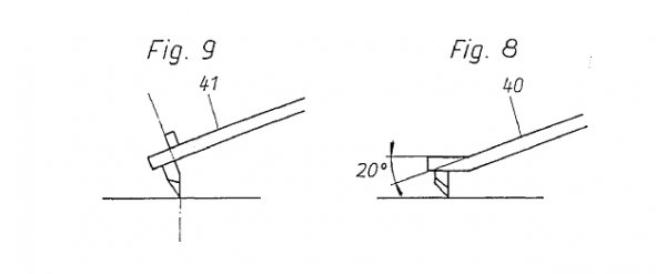

while the following figures show mounting options - figure 9 applies to how Ortofon mounts their stylus, and verifies my picture above:
The patent is short and very worth reading, as it also discusses its relation to a cutting stylus - Figure 3; notice the sole flat side:

I wanted to document a bit more Figure 7 of the Gyger tip, so I drew the following profile (sideview) diagram, to see how it works:
  • Angle A0 = 15-30 degrees as per patent; unknown yet what Ortofon may have chosen
  • Trapezoid width: 5um at the tip, 100um at the other wide end - I assume this is what Ortofon refers to as the R/r radii
  • We don't really know where the top of the groove is
Also refer to this image I borrowed from vinylengine.com:
Observations:
  • As SRA is adjusted - and because the trapezoid (facet 38) facing the groove bottom widens at the back - the cartridge tip should be raised further away from the bottom of the groove - probably less surface noise
  • Correcting what I said earlier, there is no reason why Facet 38 - the trapezoid - should be parallel to the bottom of the groove, for proper SRA
  • Because Facet 33 is flat and because it shrinks at the back (on the left), adjusting SRA results in slightly varying contact area - not sure this has much audible effect.
  • Facet 33 must shrink to be able to adjust SRA (don't want a rectangle)
  • We hope that for SRA range 0-2 degrees the contact is anywhere between the tip and the back of Facet 33. One probably must not adjust SRA beyond the back of Facet 33. Thus, proper SRA adjustment looks like an extremely narrow range
Hopefully we can get a drawing of the actual Replicant 100 for further analysis...

Refer to the following images before adjusting SRA (thanks to vinylengine and the patent):
To set SRA with the Gyger:
  1. Use a USB microscope to assert vertical reference (vertical GF) - side profile works well
  2. Adjust SRA from there
    • I like and use the mathematical model discussed in the parent thread and the original A90 thread from2010
    • The model maps _desired_ SRA to arm travel, based on a calculated effective arm length - it simply enables one to very predictably adjust things
    • However, it is still an approximation, because VTF is also inevitably affected, which imposes its own change in the SRA angle. Fremer claims that, generally speaking, a 1g of VTF change results in a ~1 degree SRA angle change; you can probably use a linear formula for this
    • I contend SRA adjustment should still be within the recommended VTF range
    • It was hard for me to adjust SRA with the microscope, due to its low resolution, and it's really time consuming
Refer to the following images:
Fremer's article is a great reference and he makes points that I completely subscribe to...
I can see clearly now what you are saying - you are correct. Contact is only made by edges 16/17 or 36/37 indeed; they are rounded to 3-8um per patent and polished. Therefore, Facet 39 is actually the vertical reference. And the tip is rounded to 5um per patent to provide clearance from the groove bottom. Moreover, the vinylengine picture is correct as is my marking of Facet 39, except that I missed that the shank of the stylus is mounted perpendicular to the cantilever which is angled - and the patent makes it explicit that Figures 6 and 7 have the advantage of mounting the stylus perpendicular to the cantilever, as is shown in my picture in the original post.
Therefore the vinylengine picture tells the whole story and clearly shows the two edges that make contact - however, all of that means that what I've been reading about this stylus having larger contact area is actually not true: it touches the groove with very narrow edges... correct?
Well, yes, but the height of the contact area is quite high vertically, so that is the key issue. The sharp 'edges' determine the scanning radius, not (directly) the contact area.
I'm totally lost on what your new diagram is supposed to be showing. It certainly doesn't seem to be depicting the operational position of the stylus at all.
