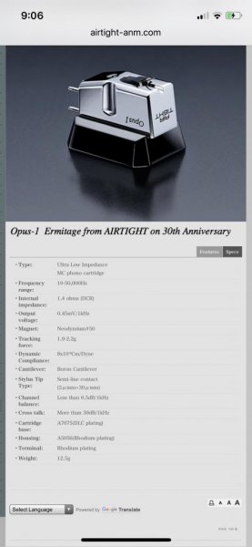

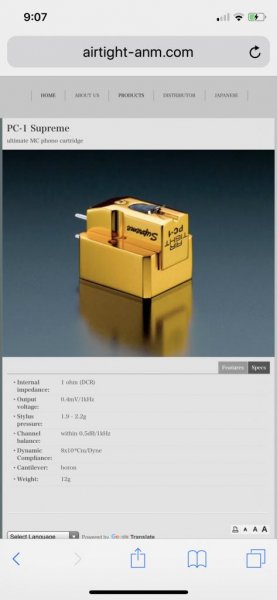

There are small design differences, but the Air Tight website lists both cantilevers as boron.

Both cantilevers are made of boron. The Air Tight website says the housing of the Opus 1 is made of duralumin.

For whatever reason, Valin made a mistake. Both cartridges have the same boron cantilever.

Miniguy, Thank you for sorting that out. I wonder if Valin was reviewing a prototype? I think I read somewhere that both Valin and Fremer tested earlier versions of the Opus 1 when it was called the Opus Magnum or something like that. I notice that the weight of each cartridge differs by 0.5g. That would create different effective masses. The cartridge compliance is spec'd the same, so resonance frequency on the same arm would be slightly different. The Opus is heavier, so on the same arm, the counterweight would move backwards slightly, changing the inertia of the arm/cartridge combination.
