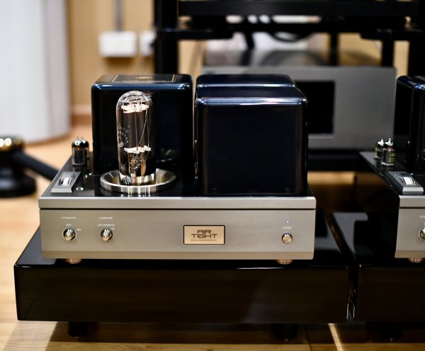

All new Air Tight SET monoblock ATM-2211

Thank you for these wonderful posts! A question, which would be the power amp of choice to drive a 91dB loudspeaker, the 2211 or the atm-2 plus?
