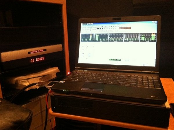

Here is an out of focus photo of my vinyl/tape archival rig. This is a Toshiba Tecra business laptop running XP and Sonoma DSD. The black box under it is a 2-slot MAGMA chasis with the Sonoma PCI card and (2) 2TB HD in a RAID 1 array. This is connected via Express slot34 card.
The DAC is the Playback Designs MPS-5 connected via ST-optical. The A-D (out of picture) is the EMM Labs ADC8VI.
This is what I call the ultimate archival rig.

That's a fabulous setup. Now you just have to pick your final turntable, arm, cartridge and phono stage.
Every time I changed something in my vinyl rig, different cartridge etc. I would think, "Hey, do I have to go and re-record the records again?" It never ends.
There were some inexpensive portable DSD recorders on ebay a year or two ao that I thought would be ideal for computer archiving, but never tried one.

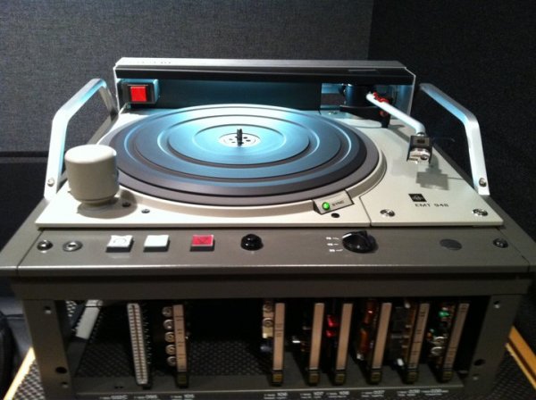

Right above the Playback Designs is my vinyl rig.

I have an SME 30 second generation with a 10 inch Da Vinci Grandezza shoehorned in. The Da Vinci is a MUCH better tone arm than the SME IV-VI I had previously. The SME 30/12 is a weightier, longer and stiffer, which I am quite sure serves to good audible purposes. However, I am completely happy with the standard SME 30 and have no desire to upgrade. (Did I really say that? Nobody will take me seriously anymore without evidence of nervosa dementia.)
That is an enviable EMT classic, Bruce, in what looks like perfect condition.
