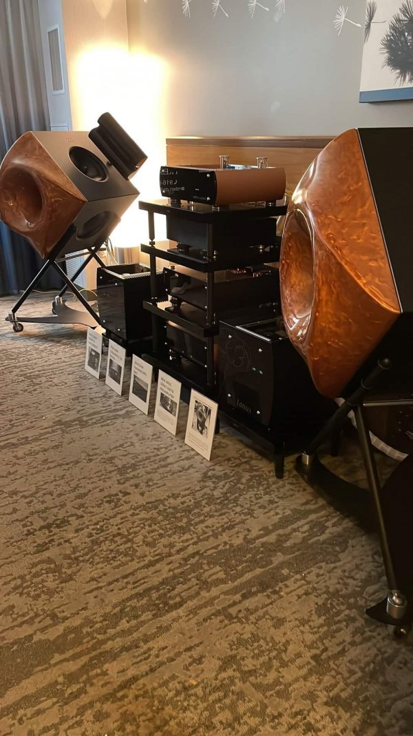

I was at axpona and heard this setup a few times . I advised many to go to that room . Some heavy hitters on here too . All the reps of this room were very kind and informative . The sound was great such a cohisive sound , i just wish it was a bigger room for these . The above first post a larger system made me have to hear these . How this large setup could have such a massive sound and not have a hint of sharpness or uneven sound alone is amazing to me . I hope other more known and skilled attendees post about this system . To me this is a room that once heard put me at such a high level it made it hard to hear most other rooms .
Hopefully the A 4.2, E213 room in Munich will prove a little more commodious and allow the Aurora’s to breath and show more of what these phenomenal transducers are capable of.
