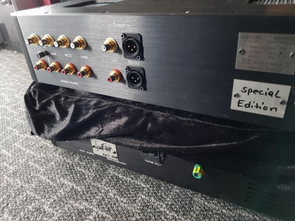

Ayon has two fixed gain inputs. The gain is very high it can play any low mc and could not play well with 0.5mV or above with cart like with GFS in my system. You can put restrictors to each input at the rear but I found it sounds best with none. Here is a pic of the rear of Ayon new prototype phono Gerhard made for me.
The old one I am using looks the same. Gerhard tries to convince me the prototype sounds even more natural and better in many ways. It is brand new. No tube hours. I only have listened to it a few hours and when I don’t find the level of transparency I am used to I just stop listening. Btw, the three phonos have exceptional transparency but I think maybe the EMT beats the other two by a hair.

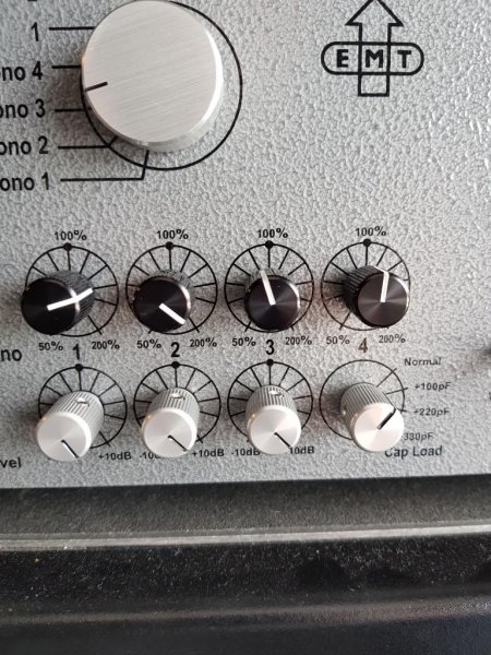

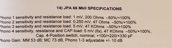

The EMT has four inputs as follow.
I had mine customized the input 3 to be the same as input 2. The gain of each input can be adjusted +/- on the fly. So as loads. It comes with equalization adjustments. If you don’t set the turnover adjustment properly it could sound lean and analytical with no life. There is also Scratch Filter knob that reduce clicks and pops. It shapes off some frequencies so I don’t use it much. The EMT can also be used as line preamp.

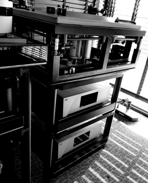

With P1, you can adjust so many things you can ever imagine. It has computer wizard that I probably will never operate by myself. There are two current inputs and one voltage input. Gianluigi said the current inputs sound better with low impedance carts. I haven’t a/b the inputs yet but I trust his ears. I have the X1 power supply. It makes big enough difference to buy.
So which one is the best? As I said before I like them all. They all sound good in their own way in my system. You read Mr. Lavigne’s Yin Yang thread and his comments. This is quite similar to that. The difference is I chose to play with vinyl front but Mike chose to play with amps.
