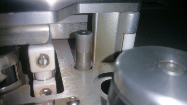

Is a picture of the capstan available :confused:
Yes, if the capstan is highly polished, you could have speed and/or wow-flutter problems. The capstan surface can be restored to it's mat surface if need be. If the capstan is just dirty, you may need a very strong solvent to clean it like acetone.

In the previous videos, some fluctuation of the recorded tone is appreciated
Here are a couple of photos:

Your capstan may be ok. I have seen worse.
Record variations may be the tape. If those variations are only in record, you may be ok since you want to only use the deck for playback. Only new MRL speed and level tapes will verify if playback is good.
You also may need a new pinch roller. It is difficult to judge the quality of the pinch roller with just photos.

Oh, yes...please do clean the capstan. One can apply a small amount of anhydrous isopropyl alcohol / IPA to a clean cloth to address the capstan shaft dirt.
Ensure no excess fluid runs down the shaft
