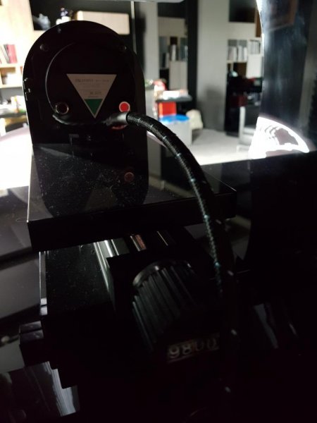

The cables of my TAD tweeters and midrange are not difficult to replace. I also plan to switch to SilverGold.
I think the difficult part is to balance the sound if different types and brands of cables are used for drivers, tweeters.
