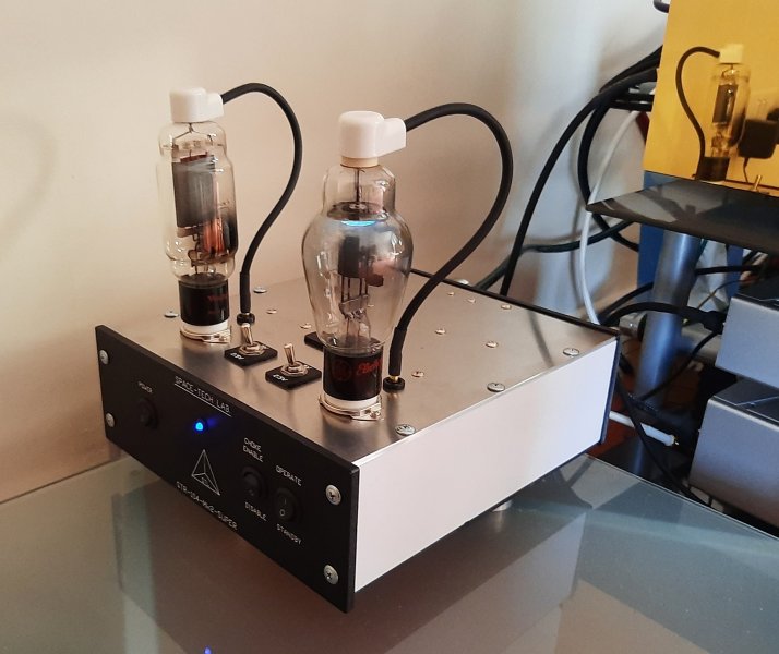

Also consider the Spacetech labs STR104Mk2 - It externalised the rectifier in its own powered box and connects via a cable to the rectifier socket. They are very good! https://space-tech-lab.com/Accessories/STR-104.php

Not sure if this is addressed at me, but....
Reactions: Massimo66
Please write your impressions and what improvements you had from using it instead of simple rectifiers, I see you use WE tubes, have you tried others?
It gives better, punchier bass, bigger sound picture with incredible sound stage, and generally a greater music density. The live and energy of the music are taking up to the next level. The front tube is an RCA 866A, the rear a 1616. Think I'll go back to 2 x 866As, just a preferable sound for me.
Swapping rectifiers in the past has given different qualities some I really liked. This STR104 elevates everything. Well worth the money IMHO, especially as some of the rarer rectis will be priced close to it
