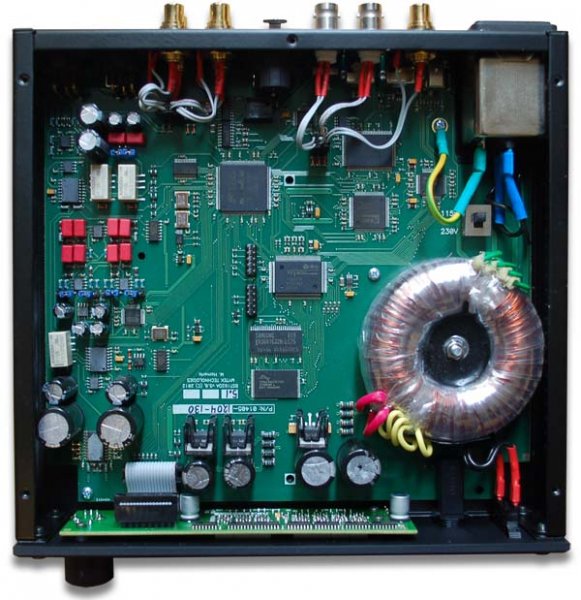

i was interested in the mytek b/c of the DSD but w/ 100 SACDs and no way to rip them yet i lost interest. i recently had the wadia 121 which is in a similar price bracket as the mytek and other reviews surfaced that prefered the Wadia 121 over the Mytek 192 for PCM and i know the berkeley is many steps ahead of the 121. pictures can say a lot, mytek top berkeley bottom:

Those two pictures juxtaposed tell me a lot about the differing approaches to DAC system design.
Firstly look at the transformers - the Mytek guys either don't know about common-mode conducted mains noise or have engineered their design cleverly to avoid it. They're using an off-the-shelf mains filter block (chassis mounted, top right) and then a toroidal transformer. The upshot of this is plenty of coupling of external mains noise to the internal circuit ground. Using an standard filter 'brick' means there are going to be Y-caps (mains to earth) and so the filtering quality depends on how clean the provided mains earth is.
In contrast the Berkeley guys have paid attention to this noise source by sourcing what looks to be a pair of antediluvian transformers. These have much lower interwinding capacitances than toroids and hence give rise to much weaker noise coupling. It looks like they're also rolling their own mains filter on the PCB (top left, it looks like two common-mode chokes are being used though I can't see very clearly).
PS I'm conjecturing here but probably Bruce already has industrial strength mains cleaning technology installed so won't be worried if kit doesn't provide its own filtering. The average domestic user hasn't heavily invested in mains purification kit.
