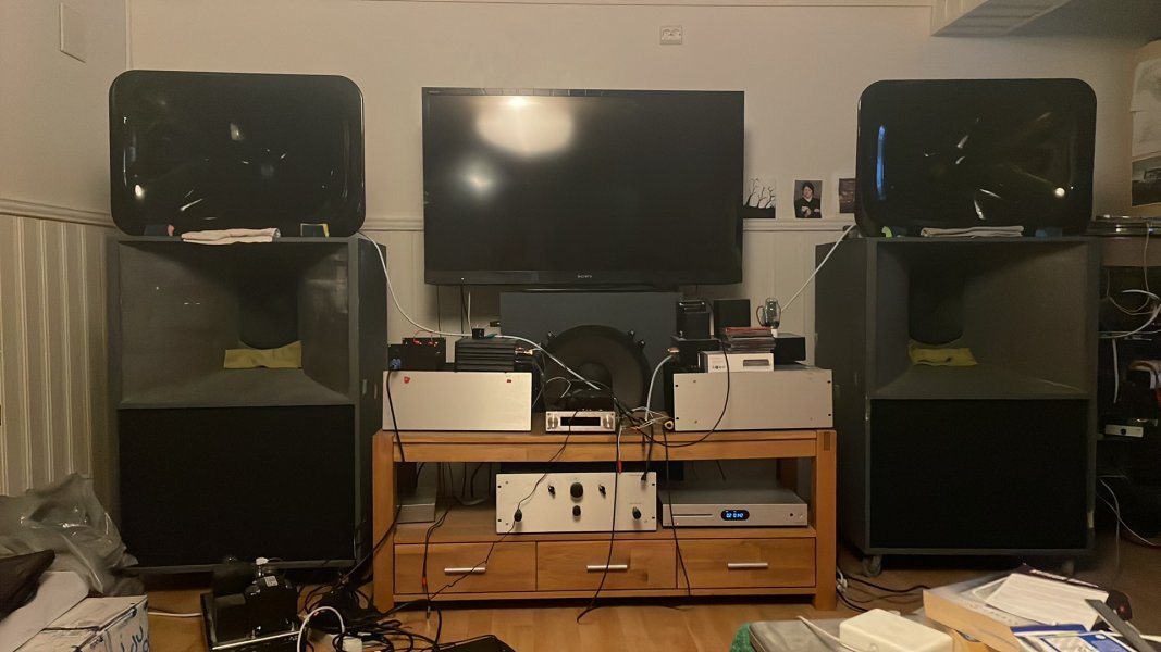

Nice system. The axi 2050 are great CDs. I have a pair in SEOS 30 horns, using altec 828 VOT cabs for bass and a jbl2242h as a sub. Sorry about the vire mess, am still experimenting :) The setup there is miniDSP flex eight, IcePower 1200as2 on the horns and a hypex nc400 on the sub. Still have a passive autoformer and 6db/oct. crossover on the horns. Will try fully active later.

Nice! A little in process wiring is a good thing while tuning in the system. I too use miniDSP but am using 2 of the 4x HD units since the processors on the HDs are better & faster. 1 DSP to control the horns only and 1 DSP for the base drivers and subs. Each DSP is driven from their own output from my preamp.
