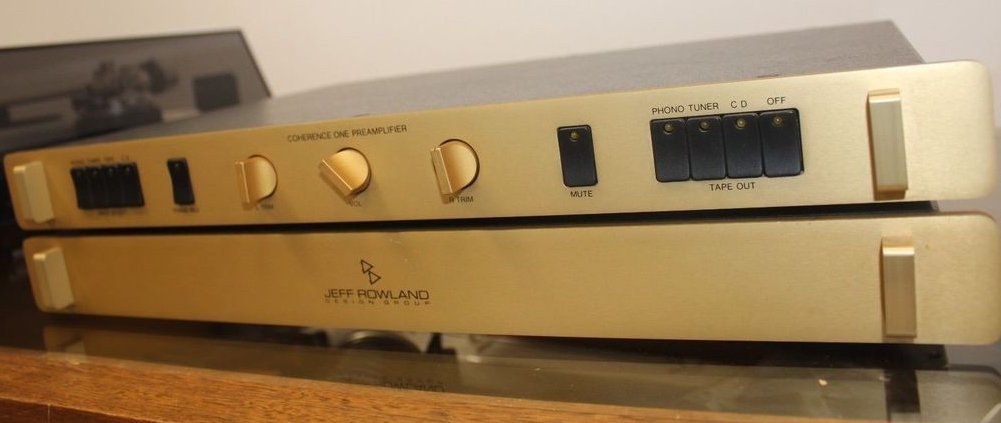

Easy.
MkI looks totally different, have a look at the attached pic which I stole elsewhere.
Otoh, there are Mk II series 1 and series 2.
To the best of my knowledge you have to open the pre, not the bps, to tell them apart.
Red pc boards: Coherence II series two
Brown boards: Coherence II series one.
Bps has brown boards in both versions.

Thanks - but I was addressing the two versions of the more recent Coherence II you own, not the Coherence One!

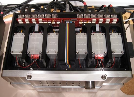

For batteries you can use any similar type, to distinguish between series I or II of Coherence series II preamp by the eye. the difference is the circuitboard color in the amp module section when in the case of I is brown/green and in the case of II is red. (Note: in the power supply section the color is the same brown/green)
