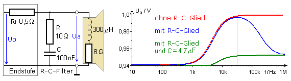

in the boxes of the loudspeaker cable ust bandwidth correction and components that ensure phase linearity. higher-impedance amplifiers need different values than low-impedance amplifiers. The output resistance and inductance of the cable have a major influence on the transmitted frequency response
HMS was the first to have this adaptation for their cables, other manufacturers have copied it.;)

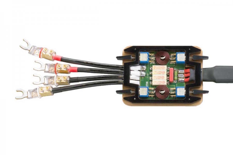

as I said, i only speak for europe in 1996 they had the first HMS cable with zobelglied adaptation. i heard it from a friend and i loved the sound. Today, Hms builds this adaptation for amplifiers for every cable for retrofitting. Called "perfect match "simply parallel to your speaker terminals and test it 3 possible settings as it sounds best.
For single and biwiring
Or Hms top speakercable suprema(open box) HMS-Suprema-Lautsprecherkabel-1.jpg
