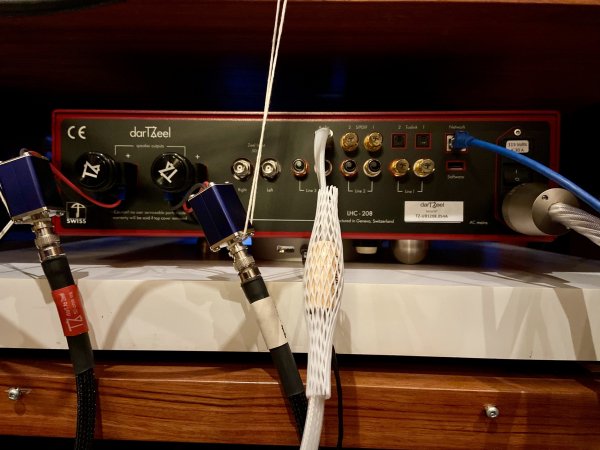

Does anyone know what the converter is for Dartzeel?
And anyone have any information or photos for the new zeel 50 ohm cable?

Those are Sucobox spade to BNC adapters. They are connected to the speaker outputs of the LHC-208 to attenuate the signal so you can plug The 208 into a preamp and use it as a stand-alone DAC. It seems convoluted but it works remarkably well.
The wire is the standard Dart to Zeel Link 50 ohm BNC cable. 50ohm BNC is the preferred interconnect between DarTZeel components.

You may find the picture below helpful. Exactly as FBHIFI describes. Latest Zeel cables are attached. Cabled up to 18NS. 208 used as DAC/Streamer only.
