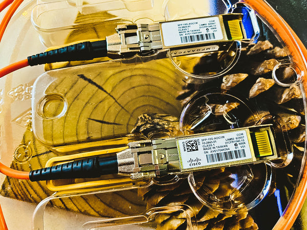

Verizon Fios router (also serves as wifi for iPad and iPhone)—CAT5—>Netgear switch GS-116 (all ethernet connected devices in home are plugged into this, including Mac Mini as Roon Server)—CAT5 to listening room—>Wall Plate—WW Starlight 8 Ethernet—>EtherRegen (stock)—>WW Plat. Starlight Ethernet—>Cary DMS-600 Streamer/DAC
I would simply add an FMC (preferably with linear power) immediately ahead of the EtherREGEN. I would use a one-meter DAC cable (direct acting optical cable) to connect from the FMC to the ER A-side. The Sonore opticalModule Deluxe v2 has the reputation of being the best FMC for audiophile use, but you could start with the freebie supplied in the AfterDark link below. No other changes or switches needed.:
