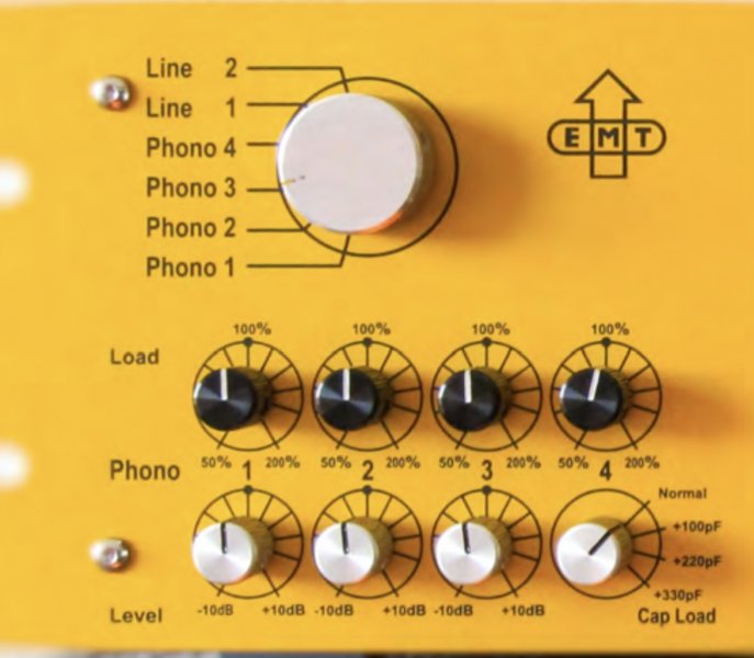

3. The Input 1 is marked 1mv, 200ohm -50%/+100%. It should mean I can set the load impedance from 100ohm to 400ohm, isn’t it? However the gain is very low. Even if I use a cart such as MSL PL with 0.5mv, it still doesn’t have enough volume unless I turn up the knob of volume on my pre very very high.
4. If I use a STUP, can I also use it into Input 4/mm and how should I put the capacitor load, into “normal”?
5. To Input 3 and 4, there’re still knobs to adjust load but they should be fixed at 47k ohm?

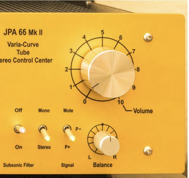

6. From The appearance, how I can tell it is a MK1 or 2 or others?

There’s a lot to unpack here.... a short response to begin. This is not the Mk2 version. Try using the variable output and adjust the main volume to about 2 o’clock (Unity gain) - be careful to adjust your systems preamp accordingly lower. IMHO, the EMT has Tremendous drive and low frequency extension. You will not realize this with fixed output. Also try experimenting with the RIAA and Hf curve.

Hi it seems a bit confusing if you look at front panel
Under phono 1 it say goes to 200% which I assume is 100% plus 100% so 200ohm would be 400ohm
plus there is 10db of gain available on dial below, changed to capacitance in phono 4, mc carts are relatively uninfluence by capacitance though the least is probably preferable

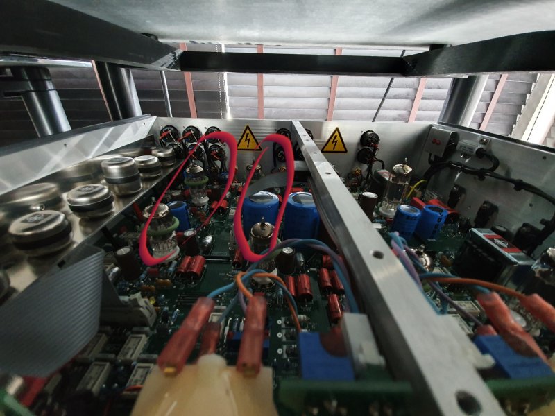

2) Each roll of 12AX7s is for each input. For example in the pic below, red circle pair is for Input1.

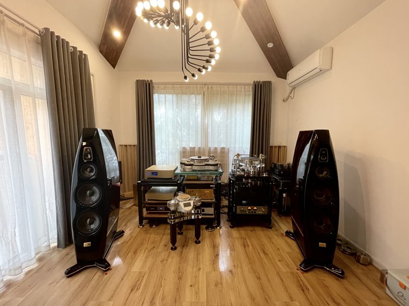

Over years’ upgrading, I ended up with this setup. Thanks for the comments and indeed it is my biggest hobby and it gives me a lot of pleasure. I read about your posts on the Zerodistortion site and you have also many sexy and wonderful gears. Hope one day I can visit your studio.

BTW, on the picture you put 2 red circles. I assume the left circle refers to the 2 tubes (up and down) for Input 1?

That was through input 1 only, specs for which I gave in that post

I had tried to connect the JPA 66 via its Pre-Out and started to enjoy the tweaks of the volume control and gain control combo, plus the curves and EQ, a lot to play with.
When I connect to the control output, the input4/mm with my London Ref. is quite low gain and I had to turn up the volume very high. Now with the new connection, I can use the volume knob to make it very listenable at my normal volume level, which is good.
I remember in an earlier thread, Bonzo mentioned that you had some issues with lower output carts on JPA66. I assume if you did the same through pre-out, it shouldn't be an issue, isn't it?
No problem with lower output carts. Bonzo and I just thought that the factory standard input1 doesn't has the drive.
Yes left circle 2 tubes up and down is for input 1.
ShawnZH
Sep 20, 2020
148
230
115
48
I see thanks Bonzo. Then input 1 even with the pre-out circuit, it is still too low gain. This is an annoying issue with JPA66 that input 1 is un-usable for many carts. Carts above 1mv are not that many. I ordered a Lyra Atlas Lambda high output version. I hope it could cope with JPA66 with its .56mv ouput.
