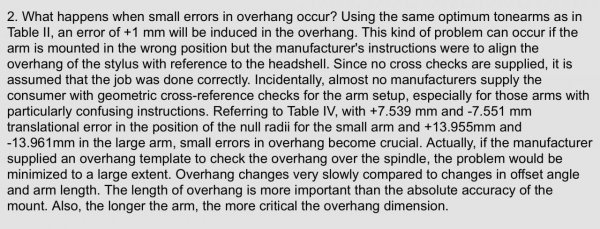

I would like to tackle the errors of alignment issue
12 inch arms have less tracking error if properly aligned 80940C43-4F83-4385-890E-7D99C7454FA2.jpg
However alignment errors can have bigger effects on longer arms

I have presented some objective data, but I have to admit, owning 9 inch and three 10inch arms, when I got a 12 inch arm, what I noticed most was the ease of the tracking, the arm seemed to glide through its arc, compared with shorter arms, which often look a bit frenetic, on their path
The issue of inertia and resonance may be more important than misalignment , which is more an issue with offset and overhang than pivot placement
Although MF is correct as far as he goes, these may not be the important issues, in terms of reproduction
