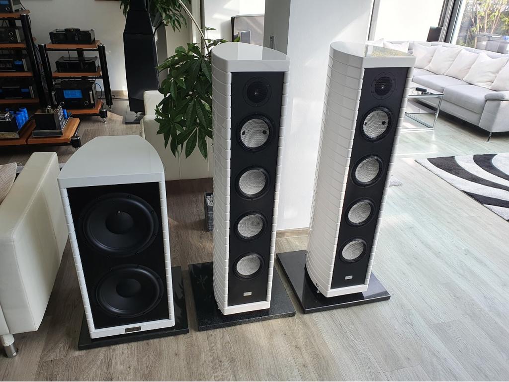

This is a thread in a German forum in which the company participates. You just have to use the google translator:
I think Merovinger use the DSP modules from fouraudio.de with acceleration sensor and touch screen operation:
The amplifier modules are from Pascal.
The subs are built the way you want them. It should also fit perfectly optically.
This shows the Gauder RC7 and the sub. It has the same white grooves as the speakers and a similar shape, so it fits perfectly:
