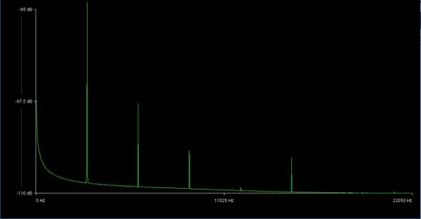

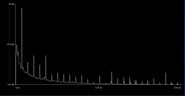

> Horn speakers again due to their efficiency are most often driven with low power triode amplifiers with distortion characteristics more friendly to our brain’s neural programming - this often manifests as an authenticity of tonal characteristics more semblant of reality than some other speaker / amp combos.
Most measurements are taken from the amp's output... but that's not what we listen to. We listen to the amp interacting with the speakers. So I captured the output of my speakers being driven with 3 different amplifiers with a measurement mic (1 kHz reading 83dB at mic, mic 2m from mid cone), and here's what I found:
100 Hz Signal
First Watt F5 (class A, PP, SS)
Gainclone (class AB, SS)
Thoress 300B (SET)
3 kHz Signal
First Watt F5
Gainclone
Thoress
10 kHz Signal
First Watt
Gainclone
Thoress
Whatever causes the euphonic sound of SET amps, it seems not to be an increase in harmonic distortion.

Hi Mani,
Interesting graphs indeed. Would be interesting to use also conduct the test with a high power solid state amp from the usual suspects and also a class D amp. Also I am not sure that test tones played like that tell the whole story as music being played poses very different demands on amplifiers than test tones and possibly we might see differences in that context.
Btw - is this into your Animas? Useful just for context.
manisandher
Feb 7, 2011
243
217
950
www.the2ndtier.com
Hi Bill,
Sure, but I used what I had to hand. BTW, the amp powers into 8 Ohms are as follows:
- First Watt ~25wpc
- Gainclone (bridged-parallel) ~200wpc
- Thoress ~8wpc
Yes, the 3 amps sound totally different to each other.
Yes, the Animas... my 'end-game' speakers :).
Mani.
100 Hz Signal
Thoress 300B (SET)
3 kHz Signal
First Watt F5
Gainclone
Thoress
10 kHz Signal
First Watt
Gainclone
Thoress
Mani.
Indeed, the Thoress even seems to be somewhat lower in level for higher harmonics at 1khz with some closer to the noise floor. I might be able to make a similar measurement if I can dig my old computer out that had good measurement software (it had FFT and wave generator functions through a good sound card).
Sorry, meant 100Hz not 1Khz.
manisandher
Feb 7, 2011
243
217
950
www.the2ndtier.com
Indeed, the Thoress even seems to be somewhat lower in level for higher harmonics at [100 Hz] with some closer to the noise floor.
Interesting, isn't it?
And BTW, the test tones were pretty loud when I took the captures. I mean, you wouldn't have wanted to spend too much time in the room for the 3 minutes that each of them played, so it's not as though the amps weren't being challenged. As I said, the 1 kHz calibration tone was registering 83dB on the SPL meter 2m from the speakers, which is pretty loud.
Mani.
