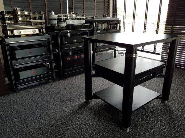

First round of assembling the Stacore rack. Took us three hours to get to second tier. Lesson learned, Must follow his instruction every words. Not difficult but tedious. So many screws to tighten and must be triangulated torqued with each leg. Jarek provided me with everything I needed including all the tools. This rack is truly high mass. You can’t shake this thing. It looks very simple but when you assemble it you will realize the the design is very well thought out and manufacture. Next week, will do a second round and finish the assembly. Take it easy right Khun David, Khun Jarek? :)

Dear Tang,
You have already achieved quite a lot doing it 1st time - congratulations! I thought you may get blocked already at the second tier positioning ;)
Yes, take it very easy. Almost like if you were setting up a cartridge.
What you see is only a part of our technology - much is hidden inside the legs. They have an innovative and complex structure - there is an inner leg inside
which is coupled to the floor but decoupled via viscoelastic material from the outer, visible leg. By that floor vibrations are much attenuated and the legs are highly damped
(knock them, they are dead silent). The drawback is the manufacture complexity - it's all a hell to make, esp quickly ;)
Take a rest and continue, I'm here to assist you. All your sweat and tears will be compensated ;)

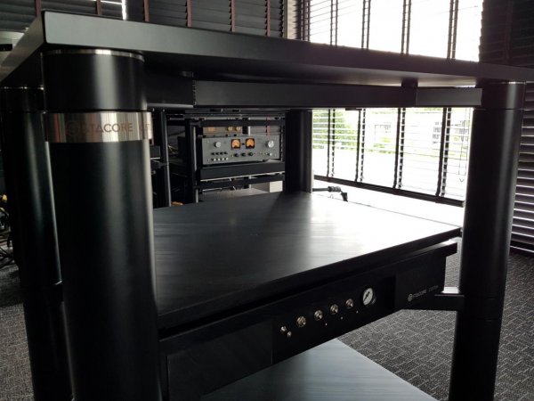

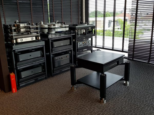

Last week was half rack. Full rack now. Big black beauty.
Tang:)

That’s v sweet indeed Tang.
Now all you have to do is move that behemoth to its final resting location.
