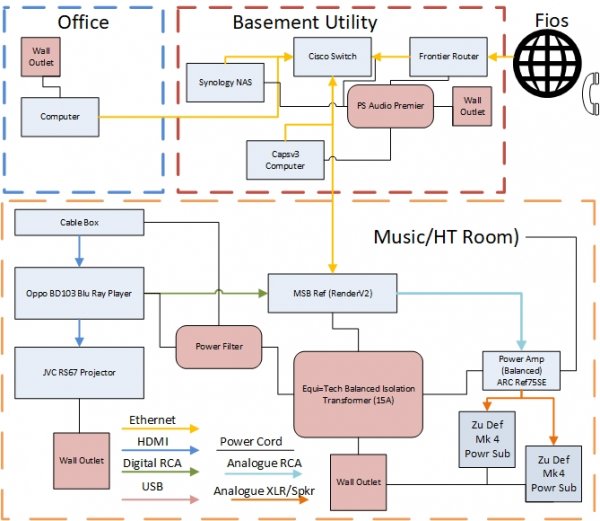

I could really use some help from you network and network audio experts. I will be replacing my lampizator Golden Gate Dac fed via USB from a capsv3 computer (linear power supply fed) as an NAA (roon + HQPlayer in office does the heavy lifting) in the music room to an MSB Reference DAC with renderer V2. My intent was to move the capsv3 computer near the switch in the basement and just plug in an ethernet cable into the MSB renderer.
Attached image shows how the network is arrange. What is the ideal network arrangement for Audio? Any other thoughts?

Hello Germanboxer,
Possible to replace your Cisco switch in the Basement Utility with a SOtM sNH-10G switch and run an optical fiber to another SOtM switch in your Music/HT Room which then connect your MSB Ref DAC with a good ethernet cable such as Vertere/Dalby Audio Meda?
I guess you will give LPS to all the network components.

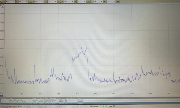

This is a measurement on ground (safety earth) with a smps plugged into the powergrid. You will measure this everywhere in your home. The scale is in KHz.

Usually the secondary is referenced (connected) to ground (safety earth) so it does not do anything about this unfortunately.
