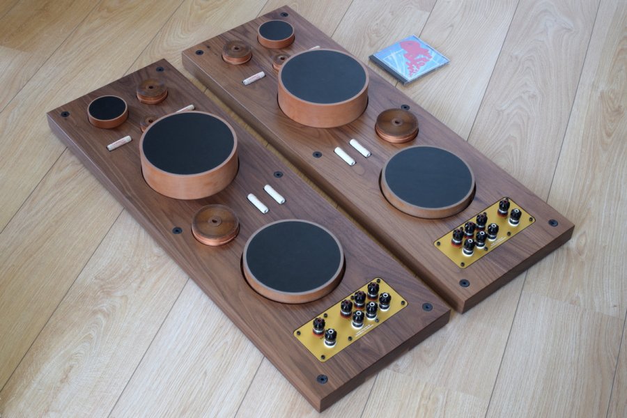

those are beautiful. are those copper/lead cylinders for resonance control? Walker pucks? i have a set i use but mine are all beat up from spike marks.
Thanks! No, everything you see is a component: capacitor, resistor, or inductor. Nothing for resonance control, other than the thick walnut board.
Look like Dueland caps to me, Mike
Yup. Duelund CAST Tinned-Copper caps. Great reviews on them from Jeff Day, among others.
These were built by Tony at Humble Homemade HiFi. Highly recommended!
Everyone should at least take a look at their existing crossovers - it’s one of the best price-performance improvements you can make. First, move it outboard, if it’s currently built into the speaker.
Second, improve the components.
Mine are still running in (it’s a long break-in time, unfortunately), but the difference vs my stock metal foil cap and ceramic resistor crossover is huge (realism, soundstage).
Look beautifully finished - enjoy. Love the attention to detail. You could consider larger diameter wire (or ribbon) or different cores (lots of options) on the inductors in time too.
