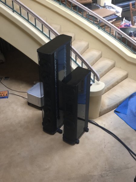

The Pantheons were still in the room, when the Tridents were brought inside. Mephisto in the middle between the Pantheons.
Speakers were laid on their side to facilitate removing the top & bottom shipping caps.
These are v tall speakers
First speaker more or less in situ.

Actually dialing the speakers in, is always the most time consuming. though fun part of this exercise. T2#18.jpg
Trident 2 and Pantheon
Gryphon Black Spikes with Artesania Decoupling Discs. The display on the floor shows the bass amplitude, as well as damping. Adjustments, are made from the remote control or from the back of the speaker.
Photo credit - Joseph Cali
The room measures approx. 40 x 31 x 23'
The speakers have a 500WPC Class AB amplifier on the back panel that drives the 4 x 8" woofers in a sealed enclosure.
We ended up moving the two speakers about 6" away from the staircase (and into the room) & 1 1/4" closer to the staircase. After we found the correct location for each speaker, then we spiked them & mounted them on the Artesania 4" Decoupling Discs.
Total time spent from start to finish, a little shy of nine hours. My deepest gratitude to Joe Cali for taking care of the installation.
