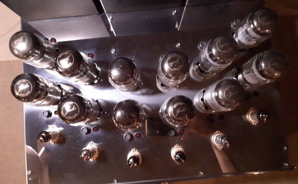

It is auto bias. I had to verify it at the dealer's by asking them to open up the bottom plate for me to see if there are manual bias pots, and there were none. Also beside each power tube socket is a small red LED indicator. If it lights up, time to change the power tubes, and I was told that even its other partner has to be changed even thought its LED did not light up.

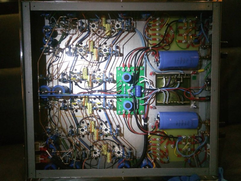

Nice point to point wiring . I think the predecessor the DA/Defy 7 had a circuit board but am not sure . Enjoy it in good health Phillip .
I owned the Defy 7, and yes it did indeed have a circuit board and had to be manually biased in groups of 3 power tubes. A pain to maintain and bias, but sublime sound.

Hi,

To me, manual bias means there will be biasing POTS. So you can adjust and set it with a digital voltmeter. The PA100 does not have any pots at all. So it CANNOT be manual. There is nothing for you to calibrate on when you change tubes. Just make sure they are Matched pair or matched sextets, etc. So far, after 3 years, a few fuse snapped and it was like a voltage surge. Change the 160mA fuse and ready to go again. Of course, after 2000 hours, life begins to shorten for the KT88 tubes. That is where I am now.

Any definite answer on the type of bias in the PA 100? On the Jadis web site it says MANUAL ... Would GREATLY appreciate the feedback!
I believe there is a misprint on the manual and all dealers copy it, as Manual. The biasing system is push pull which is the same as my old Jadis JA 200 class A amp, and also the same as the JA120 amp, and the indication of these 2 amps is called Automatic Bias. A clear misprint of the PA100, if you ask me.

Here is an actual photo I took of the underchassis of the PA100. It was a demo amp in the showroom and I asked to check the innards to make sure if there are biasing POTs or not. I wanted to see there were none before I bought it. So there was none whatsoever. So how can anyone call that Manual biasing? How do you do it? Where?
No pots to stick the voltmeter in, and no adjustment trim pots either.

No pots or trimmers either from the top chassis.
