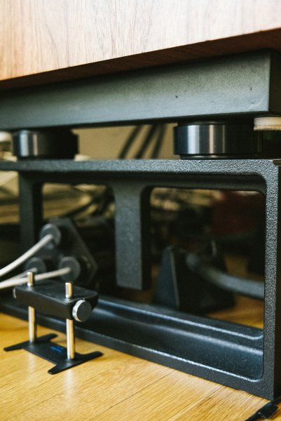

Hope everyone is having a wonderful week (trying to be optimistic here) Since nowadays we have more time to listen to the system , I started being very critical of my JBL 4350's bass performance, when playing Piano Sonata , most jazz its really good, but when I am listening to bass heavy tracks , the bass just doesn't " sink " its almost like the excursion of the dual 15" woofer are limited, tried all different test, and it is going down easily 32 hz flat, and the system is DIRAC with DATASAT driven by a BOULDER 2060 ,,, so it really " technically " should sound like a torpedo has exploded in your room, however
the bass is there somehow but disappears too fast in a lot track , and doesn't " sink " and flood the floor if you know what I am trying to explain.
Now all technical tuning side aside, I have been thinking if it could be the isolation of the Speaker itself. ?!!
I do have another sub working behind the 4350 , and those are working great so it made the woofer on the 4350 sound really not working.. lol
I am currently using 2 TACO speaker stand to bring the 4350 up to ear height with the tweeter and then between the speaker I am using the HRS nimbus system , and just TACO metal stand directly touching the wood floor ( raised foundation) , but I am wondering if there are better options for the 4350 that our fellow JBL experts has tried in the past that will help with the bass performance.
Any advice is highly appreciated , thank you again all for your time !
stay healthy and stay safe !

So many reasons
1. try turning subwoofer off and see if better could be be cancelling woofer, if better try reversing polarity
2. room mode try putting subwoofer in same place and see if same effect
3. move around the room with subwoofer is off and see if bass is better in certain parts of room, if yes consider moving listening position
4. distance to side walls, may be cancelling low frequencies consider moving speakers
5 . Floor bounce better elevated, try thick rug in front of woofers
6. distance to back wall, may be reflecting back and cancelling forward wave, either pull out or push back speakers till bass fills

Actually I think you are right , it might be the room mode, but what is the best way to know how much back or forth do I need to move the speakers to make it sound right ?

One Way is use a recording with running bass
then starting moving forward and back or sideways , tthe most common issue are the side walls as these if at wrong distance can cancel the mid bass

Is there like a software that we can calculate it ? I have a feeling its the side walls, however , I don't have much choice to move them around,.... lets see what we can do ,but man these are common issue I guess with LARGER speakers right?

Yep more bass more issues, you could experiment by putting some padding pillows, or acoustic panels on the wall and first reflection point
yes there is software here is a simple one http://www.cardas.com/speaker_placement.php
