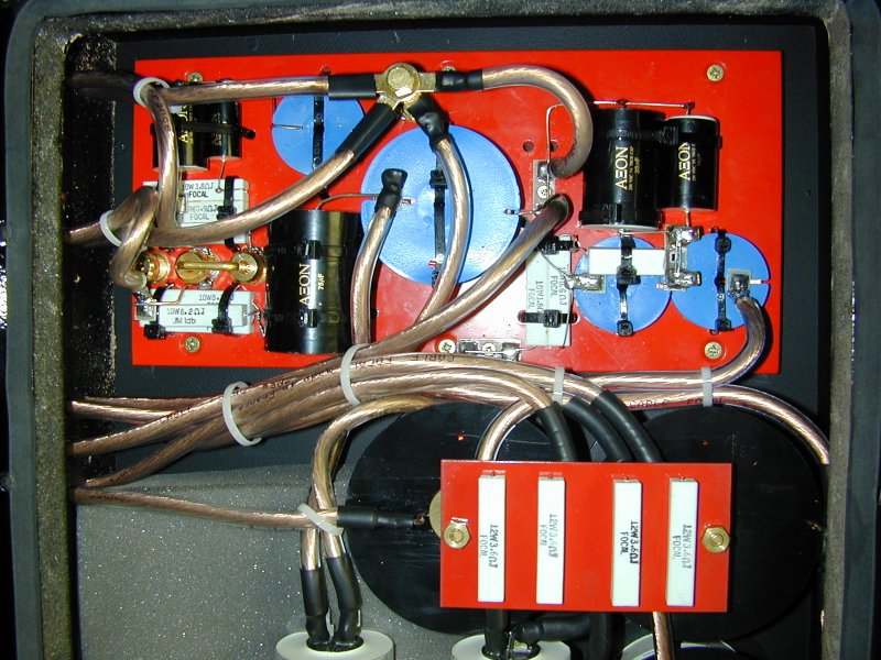

Hello, I am new to the forum. I have a pair of first generation JM Lab Grande Utopia's manufactured in 1998. I read in an early review that the only tone control for them is a jumper wire located behind the access plate on the back of the upper 11" woofer box. Focal no longer has even an electronic version of speaker manual and the North American distributor does not know which position of the jumper is the +1 dB position and which is the 0 dB position. Can anyone help?

Thank you Gregadd, the manual is for the third generation of the Grande Utopia with the EM bass driver. Focal also place the jumpers for this speaker on the external rear of the speaker. I have attached the photo that the North American distributor sent to me, but even they don't know which position of the jumper is which. The jumper is visible in the mid-upper left hand corner of the photo. JMLGU_Xover.JPG

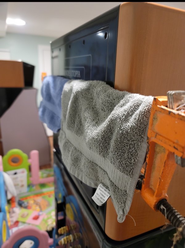

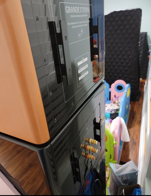

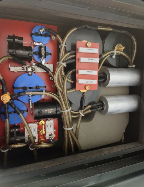

The top jumper position is medium. The bottom would be brighter. No jumper installed would be lowest position.
Version3
Sep 5, 2021
2
1
35

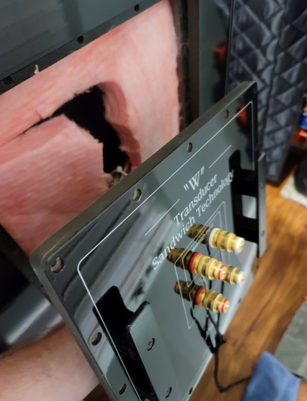

Also, I had to have custom steel handles manufactured and a steel bar to pull those plates off. I am not sure how you could possibly remove them without damaging the cabinets.
