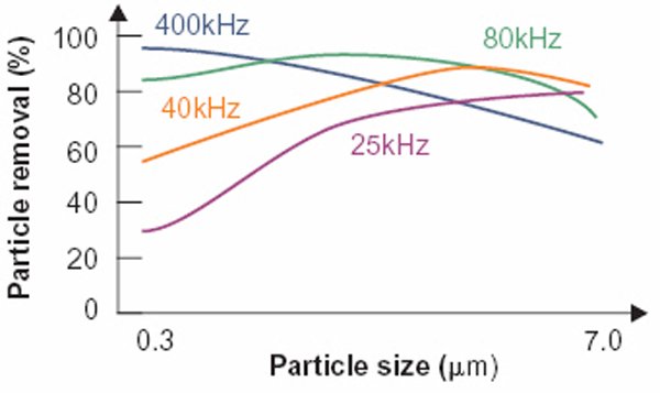

Hello Marty,
Several of your questions are specific to the AudioDesk (ADS) and KLaudio (KL) machines. KL offers two machines. I own a pre-pro model ADS and have not had any problems with it and it operates after several the same as when new. I do not have a KL machine, though I've seen one operate and have friends who own it.
I now (almost) exclusively use my own home-built US-RCM which I am confident is superior to a desktop unit. Superior in cleaning, operation, maintenance and control. Whatever knowledges I have are largely oriented to ultrasonic cleaning per se, not to a specific desktop machine. There is far far more information within the USC industry somewhat oriented to your questions but not specific to record cleaning. I'll try speaking to your questions in part, but I may not have answers exactly specific to ADS and KL. I have better information on the USC machine I use.
Power - one way to look at this is in terms of watts per gallan. There is an inverse relationship between liquid volume and the power density required to reach cavitation levels in that liquid. It may seem odd but larger capacity tanks need lower watts/gallon than smaller tanks. My Elmasonic machine with a ~3.3 gallon capacity has an effective power of 330 watts. A ~1.5 gallon machine may use say 180 watts. There is a point where cavitation levels off, where more power will not create more cavitation.
Location - where transducers are located is a function of the specific application. If you have a machine that cleans more than one record at a time, mounting transducers on the walls is likely less effective than mounting them on the bottom. Cavitation creates vacuum bubbles in the watter. Ideally you want the bubbles well dispersed across the surface of the object to be cleaned. Cavitation is strongest where the transducer is and typically you want to disperse it to insure uniformity of cleaning. My Elmasonic P120 has 6 transducers on the bottom of the tank.
Disruption - this is an interesting question, and I don't have a definitive answer. My take on the ADS machine is to not understand it primarily or solely as a USC. Though the cavitatiion it offers is obvious meant to dislodge particles from the record. My sense of it is the brushes probably do not pervent caviation from striking the sides of its record. Fwiw, bubbles strike the inside of the tank as well, on any machine. Depending on the type of material used, some tanks will last longer than others.
Brushes - I believe the brushes are one of the primary cleaning mechanism of the ADS machine. I seriously doubt they get into the bottom of a record groove. Remember ADS cleans via three mechanisms: brushes, ultrasonics, surfactants. All of these contribute to the reult you get. I have no definitive word on this but speculate that surfactant plus brushes are involved in a large part of the cleaning.
Wave travel - sound waves can travel around objects. While cavitation is created sonically, I don't think of it terms of waves, but in terms of the vacuum bubbles it creates. They do the work - smacking into a record and imploding. That's all they do. If an implosion dislodges a piece of dirt, that's good. To me part of the trick is getting bubbles where the dirt resides. That's why I'm inclined to both higher and lower frequency transduction. I've posted this graphic before, but here it is again.
Wetting agent - I use Ilfotol, a non-ionic wetting agent used as a final rinse before drying films. It can also be used to clean plastic and glass camera lenses and has anitstatic properties. I'm not a chemist but from experience I am confident it will not harm vinyl. Both Ilfotol and Isopropyl Alcohol are surfactants. Another reason I use a wetting agent is because in addition to its cleaning properties it breaks down the surface tension of the water which helps get it and the IPA into the groove. But yes, a v. small amount. I suspect KL does not use it because one of their primary claims is that they use water only.
I cannot keep up with this very (very) long thread, but it does have a lot of information on USC record cleaning.

- Normally, I don't do double cleanings or pre-cleanings; have run across maybe a dozen records that I've recleaned in my diy rcm.
- I suggest a minimum of 1-1/2" between records on a spindle. You might ask the width of a single puck to figure how many you'll need.
- As long as the tank water is kept clean by the filter, air drying works fine - either way it's all evaporation. You might want to try it before paying for a fan box. I suggest using a TDS meter to keep tabs on water quality; they are inexpensive.
- Looked at the ultrasonic.com link you posted. It didn't really have much detail, at least that I saw and I didn't spend of time looking for it. But it sounds like you have the information you need. The Trusonik tank picture shows a drain, so it would be easy make your own filter if you chose.
- Fwiw, you don't have to buy cleaning agents from them as you can use whatever you want, assuming the tank interior is stainless. Have fun!
