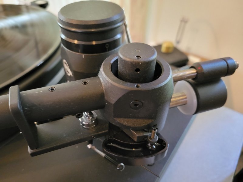

Hi 'SOS'
Your 4Point counter weights appear to be too far back from the main tube assembly. Ideally they should be as close as possible to the main tube assembly.
And you don't want to have a loose / floating main counterweight spacer. It should be tight against another main counterweight or taken off.
Having the above counter weights set-up correctly will have a far greater sonic benefit than whether you have a 'rubber gaumet' in the unused trough assembly bolt fixing hole or not !

Here is a picture of my counterweight illustrating Bonesy's point on the lower weight. Maybe I need adjust my lower weight so my upper weight is close the the assembly:

For me it is interesting that the use of the correct counterweight(s) as near to the bearing (and both of that!) is still not common knowledge. These advices were already in the 80ies with some tonearms and nothing new or special with a 4P.
You both and maybe other user should try to follow these recommendations and listen…. and report about it…

Ideally the main (largest) counter balance weight on the 4Point 11" (and I guess also the 14") should be directly up against / touching the main tube assembly housing without a PVC spacer (as shown in the Kuzma manual). Thereafter smaller weights are added complete with PVC spacers between them and the main counterweight and each other which should be tight against the main weight and each other (as shown in 'jfrech' photo above showing two PVC spacers between each of the smaller counterweights, albeit not to have the first PVC spacer for the main counterweight on the side that is touching the main arm assembly where there shouldn't be one).
Also (ideally) the small counter weight should also be close to the main tube assembly housing as possible (if this is practicably possible) which may require removing one of the lower weight counterweights and replacing with a lighter counter weight.
Sorry WBF Members, after just checking my Kuzma 4point 11" arm, what I wrote regarding not having a PVC spacer between the main (largest / thickest) counter weight is not correct / true.
It should have the PVC spacer which is the thickest one (only one of this thickness) that comes with the 4Point 11" arm between the counterweight and the main tube assembly housing with the counterweight screwed up against this PVC spacer and the main tube assembly.
Apologies for any inconveniences caused (hopefully none) or wasting peoples time in checking, reading up etc.
