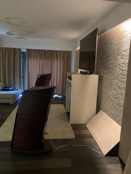

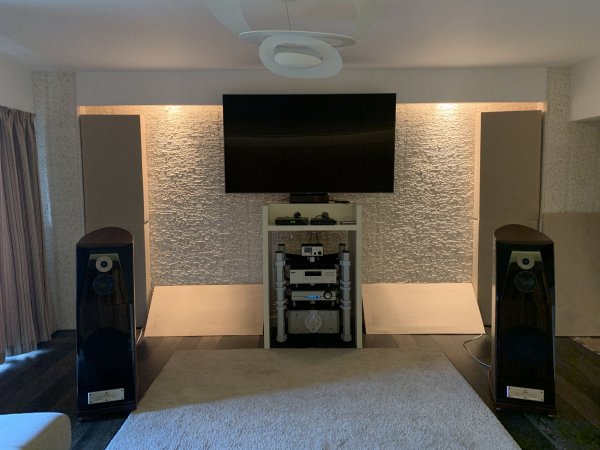

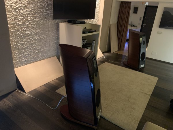

This would be the room. L = 690cm, l = 565cm, H = 265cm (to Rigips board) and 275cm to concrete slab. The 10cm fake ceiling is filled with rockwool. The white hashed areas are acoustic panels/bass traps. Distance from listening position to back wall is 210cm or approx. 30% of total length of the room. Distance between speakers and to side walls have ratios of 0.25 - 0.5 - 0.25 (145 - 285 - 145). Listening triangle is isosceles triangle with 2 sides of 330-335cm and the short side between speakers of 285cm. Speakers are angled a little bit outward (tweeter axis passes some 25cm to the leaft and right of my ears). The S in front of the couch is a table made by me and also filled with rockwool (on top of it there's a large glass panel (the only thing that messes a bit the high-frequency dispersion). I can say that generally I'm happy with the resonance and reverberation control (sound doesn't have much reverberation but isn't dead either). Green lines are natural stone (soft limestone) on walls that make a good dispersion pattern for high-frequencies. Windows on the left and rear wall + open room entrance at the upper right have thick absorbant curtains.

Thanks for posting the diagram of your room. Here are a couple of observations.
1. The distance to the wall behind your speaker should be measured from the front of your speakers. (Really from the acoustic center but the front is pretty close to that). I assumed that added an additional 60cm between the front of the speaker and the wall.
2. You room (like many) is acoustically complex with the bar and the opening to the front right.
3. I did a quick calculation based on your room dimensions and speaker placement. I had to assume that your speakers are 61cm (2') deep. Given that you are getting a SBIR nulls at 80Hz from the close sidewall, 46 Hz from the front wall, 43 Hz from the rear wall and 36Hz from the far side wall. If I assume you are getting a reflection from the bar then that would cause a null at almost the exact same as the left speaker (80Hz). This 80Hz null is probably why you are not getting that midbass slam.
I echo one of the above posts. The best thing to do is to get a mic and take a measurement to see your frequency response in the bass. Trying to absorb the 80Hz wave at the sidewall will be a challenge and would require a pretty thick (12") absorber.
The best solution may involve a pair of subwoofers and a crossover.
Speaker is inclined but from midrange driver to the port on the back there's like 50cm that should be added to the distance from the rear wall. I will try to get some mic measurements if possible. Would you recommend 2 x 12" absorbers on both side walls (one on the left, behind the curtain and in front of the window and the other one under that 2m long painting) ?
PS : Exactly above the listening point I made a soffit going 30cm down from the ceiling ( between 2 beams ) that is represented by the red rectangle on the drawing. That one is also filled with rockwool.

Fuscobal, making absorbers is cheap so i would make a big one 3'x5' and as deep as you can. Even 12" only absorbs 60-70% at 80 hz. Use pink fluffy insulation for this and not rockwool. The fluffy insulation works much better for deep absorbers. Then place it at the point of fiirst reflection on the sidewall and see if that resolves the midbass issue

Only ¨ problem ¨ i see with the room is the opening in the right corner , i believe you close this with a curtain .
If you put a solid door there , you have more pressure build up in the room
