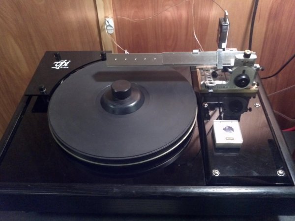

is anyone here running this arm? Terminator T-3 by Trans-Fi. 2012-03-04_11-53-27_816.jpg
I got into a bit of something with Sparky earlier in another thread and for that I'm sorry, but this seems a wonderful arm for the money. Runs on less than 0.2 psi (I usually run as low as 0.16 psi) Easy as pie to set-up. Tracks everything I throw on it. Sound just flows off the record in a way that's unbelievable. Easily adjustable for VTA/SRA on the fly. Adjustable for azimuth but this is a more difficult adjustment. Not temperamental at all, I have tweaked it one time in the last few months before realizing user error was causing the problem. Arm wands with fine silver wire available for reasonable price. Easily competes with my SME-V. Air pump is next to silent and wouldn't be too loud in apartment settings. Downside is the record must be slid under the tonearm that is fixed over the platter. Any other users out there in WBF?
mep
9,481
17
Uh, how much is that contraption?
WntrMute2
Sep 23, 2010
22
908
Royal Oak, Michigan
Direct from Trans-Fi, it is 750 British Pounds or just over $1,000 US where I am. Additional tonearms with the fine silver Litz wire are $200.00 US in the length I use. The air pump and surge tank are $40-50 US. It is sort of a contraption but sounds as polished as almost anything I've heard and I spend a fair amount of time listening to other peoples' analog rigs. No relation to the business, just a fan that sees a way into true high-end sound at beer prices to mix metaphors
http://www.trans-fi.com/terminatortonearm.htm

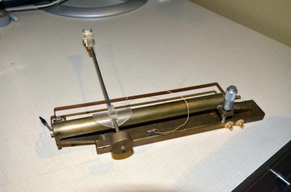

Dennesen ABLT-1 serial number 1
Before it was licensed to Dennesen, it doesn't look as good without the gold plating, but it sounds the same. These first generation were simpler, but had the key features including adjustable VTA (while playing, of course). I remember showing it around Boston, the Boston Audio Society and local companies. I remember Tomlinson Holman had a collection of oddly warped records chosen to make anything mistrack. This worked with all of them. There exists a stash of parts from the pre-production run. I restore antique telescopes as well as keep and listen to a lot of vintage audio gear. It was a fun experience, going through the patent process while I was still in college doing physics.
Alan Sliski View attachment 5401 View attachment 5402
It really does look like antique brass medical or astronomical instrument. I'll bet a 'retrophile' builder could come up with a turntable that had an astrolabe and some other stuff that makes it look like something Da Vinci built.
Is this the UR arm of lateral trackers? (I use one, a tad more modern, but this is fascinating. Thanks for posting).
PS. It either was very subtle in the way you described it, or you are being modest, since you apparently invented it, according to the patent abstract:
http://www.freepatentsonline.com/4455641.pdf

Yes Alan is one of the original patent holders of the air bearing tone arm. Alan and I happened to meet purely coincidentally through non-audio work about 15 years ago (he was developing a minaturized low energy X-ray machine for treating cancer for Photoelectron Corp in Boston and my group at NYMC was doing the biology). The story of how we met though is amusing though. I was sitting in the company's dining facilities and noticed all these exquisitely restored vintage audio components like a Scott tuner sitting in the room. Immediately my high end radar went off and I asked my host who that equipment belonged to? My host then proceeded to introduce me to Alan and we hit it off immediately. Interestingly we lost touch after I left academics and we rehooked up here courtesy of WBF.

The turntable was put together when I was building the tonearms, being a physicist I don't go too deep down the rabbit hole of high end audio, but if there are actual principles involved, then there is work to be done. Basically, the Kenwood KD-500 spins records at a constant speed, has a flat area and room to place the tonearm, and doesn't generate it's own noise. Acoustic feedback into the structure of the turntable base is a real phenomenon, so i did what I could to minimize this, add mass and lower the Q of the base. The Kenwood is made of a cast resin composite material that is a very good start to this. I took the bottom off and found that the cavities in between the ribbed structure of the casting could be packed with pieces of 1/8 inch thick sheet lead and a material called duxseal, a sticky, non-hardening putty like stuff originally developed for sealing air conditioning ducts. It has been used for acoustic damping of audio gear for years. Layers of lead and duxseal fill the cavities and then I put the bottom back on. It's quite heavy, and does not ring when tapped.
The tonearm was invented to allow the two degrees of freedom that one wants, frictionless linear motion and a rotary motion about the axis of the air bearing tube. The design of the carrier is such that it is passively self-aligning, something I consider an advance over the Rabinow arm of the time. Mechanical bearings cannot be made with low enough friction so that the stylus can provide the only motive force. Making it non-jamming was accomplished by removing the parts of the half-cylinder that jam, another basic principle in physics. There is a row of tiny holes in the top of the air bearing tube that support the mass of the tonearm. Vertical tracking angle was a hot topic of conversation at the time, and I was curious, so I made it adjustable while in use. Very few people could find the same VTA just by listening, of any. There is no need for the carrier to go all the way around the air bearing tube unless you want to use it in a zero G environment. Switching cartridges for A-B testing takes ten seconds or so with a few pre-configured arms ready to go. The only contact point on the tonearm is the stylus, I think this is a good principle.

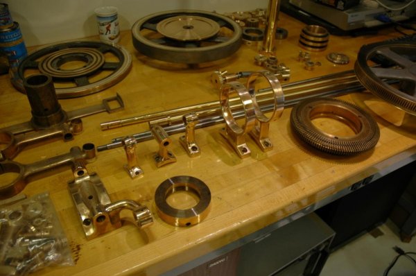

Here is a picture of some of the parts for the telescope

The parts are gorgeous. I assume it is manually cranked, gear-driven adjustments? Does it mount on a wooden tripod?
