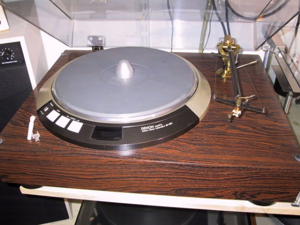

Even a bit late...here's my 2c on the subject.
I love tangential arms.I use them from day one...that is 1983.
My cartridges last forever and my records sound very well preserved for some reason...?
I have heard a lot of other arms but in some way they don't cut it for me.
Maybe my ears and brain are too biased after so many years of getting used to the tangential sound...
Just like ribbon tweeters...i like nothing else.
(Oops...they all do have a sound, like anything in audio)
On the other hand i have access to Kuzma's air driven tangential arm and have heard the LFT arm...very good but all this paraphernalia that is needed to make it work is a turn off for me...even though complexity doesn't hurt me on other departments of audio gear.
And "me too" i wouldn't touch the Clearaudio tangentials...
My turntables use servo driven arms, both use tiny pivoting sensors to always keep the arm straight but move the arm carrier with different techniques...they both work veeery well.
IMHO servo is not an anathema if properly executed.
Each one has it's good and bad points (these i have tried to fix within my brain and financial power).
Very proud of owning both, extremely happy with their sound and i'm not looking for something else.

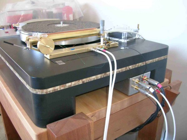

Long time lurker. First post.
Almost two years ago I saw, in Post #112, that there is “a stash of parts from the pre-production run” for this tonearm.
I bought one as a partially assembled kit.
I made some modifications. Not that it needed any. It’s just more fun.
I added magnetic damping. To do that I replaced the original cueing rail with ¼” square copper bar stock and hung a neodymium magnet from the arm tube so it traveled closely along that copper bar. The Dennesen production version also had magnetic damping.
I lowered the counterweight to lower center of gravity to be pretty much at the pivot point (neutral balance). That had the side benefit of being able to use the arm as a level indicator in the direction of arm travel. Adjust the counterweight for zero VTF and let it go, with the air turned on of course.
I used to have access to a laser cutter that could cut ¼” Plexiglass. I used it to fabricate the damping magnet holder and the thing that lowers the counterweight.
The arm tube I selected is carbon fiber. It’s conductive so I was able to ground it by running a bare 30AWG wire down its length.
The signal and ground wires that exit the arm are #38AWG magnet wire for flexibility.
I added a brass weight at the headshell to adjust the effective mass for the Dynavector XX2-MK2 cartridge. I also purchased a heavier counterweight so it would balance with the extra headshell weight.

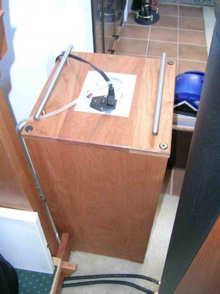

Two Medo AC0102 air pumps are used to supply the air. They’re wired so that when one breathes in the other breathes out. They are cooled by a quiet 12VDC computer fan. All of that and a surge tank is enclosed in a box with a pressure gauge on top. It’s pretty quiet.
One of the properties of this tonearm that I think is significant is in the geometry of the airfoil. It allows the arm to pivot slightly so that, for very small horizontal excursions, the cartridge thinks it’s on a pivoted arm. It means that, unlike many other linear trackers, the effective mass of the arm is similar in both the horizontal and vertical directions. That geometry also helps prevent the arm from getting jammed up.
The turntable is made from Empire 208 parts on a PaperStone plinth. I didn’t have the heart to drill holes in the plinth for arm attachment. So I used the cheesier method of some card stock and adhesive tape. The card stock is double-sided taped to the base of the arm and then the card is taped to the plinth. It works well enough.
The ABLT-1 works beautifully and the whole setup sounds great to me.
