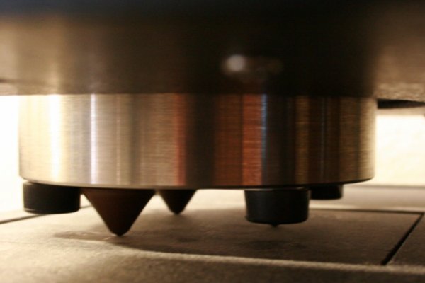

Yeah, it might not be the belt. I've got an original Aries and experimented with the same issue. I'm sure that the belt is transfering some noise, but in my system I noticed a none to subtle reduction in the noise floor by simply isolating the motor. I had a few small ceramic cones that I placed under the motor and then put my ear directly on the plinth for a listen and there was MUCH less vibration being transferred. Give it a shot, you might be pleasently suprised!
