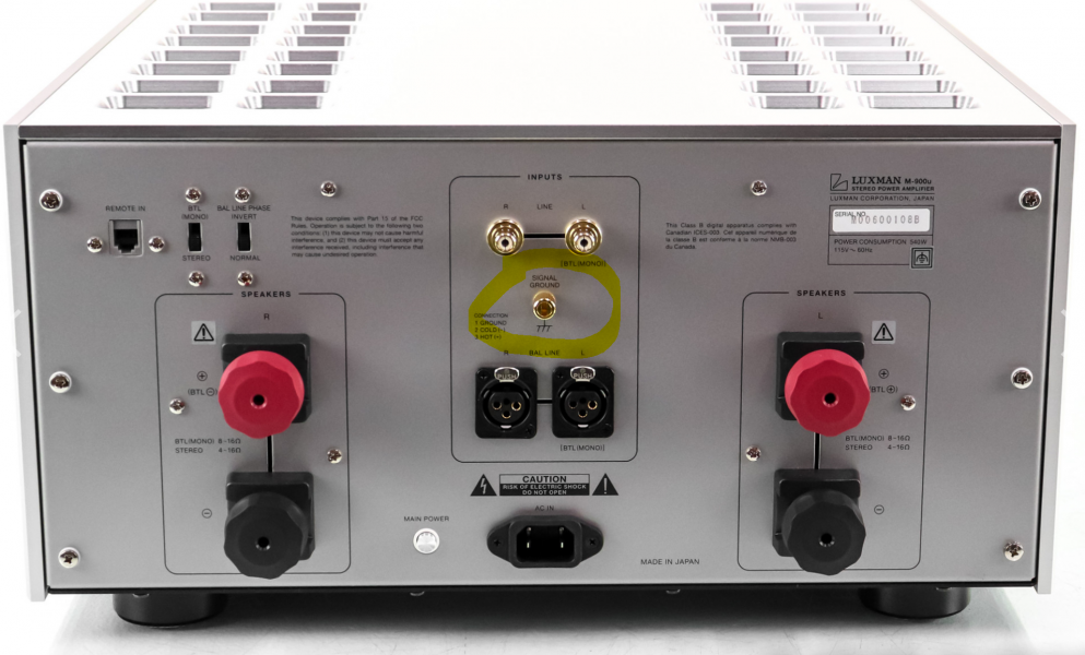

My question is: has someone already tried to connect M900 u ground socket located on the chassis to the earth ? For which result/improvement?

...the Luxmans are class2. The ground at the device IEC fixture is not connected internally. That is, the ground conductor from the wall ends at the fixture itself. The ground lug on the back is signal ground, not earth ground. I could not fully understand the comment posted back from Luxman France.

"The chassis ground is an earth for the signal, it is not identical to the earth connection on the mains base"
So I would like to use this connector (see below)
MarcusBarkus did you try to use the signal ground socket of the M900u?
I don't want to spend a lot of money for this connection (and if it's worth doing it)...

...I have not done anything with a ground scheme in my system. A couple of years ago, I did a dive into all this, but IMO it's very confusing, and arbitrary as well. The Luxman guys said not to mess around with grounding their gear, and frankly, I have no problem I am trying to solve.
I considered the various "sand-boxes" to connect to the signal ground lug on the amps, but IMO those boxes are ugly, expensive and take up a lot of space. And even a demo/experiment is going to be challenging to carry out, and again: I have no problem I am trying to solve.
I like Shunyata as a company, so when the Altaira boxes came along, I read everything I could find. If I recall correctly, the Shunyata docs identified the Luxman gear (by measurements and type, not by name) as not suited to the Altaira products.
So, on balance, it doesn't seem worth (to me) it to mess around with a lot of ancillary "ground" products, all of which are not actually grounding at all, in the conventional sense.
Now that said, reading in the Taiko thread this morning, I was reminded of the "old" Setchi product Taiko used to sell. This made me think of the Audio Quest DBS devices, and some of the info mentioned in Shunyata patents, with a small battery, wire (or charge) attached to various cables, in various places/configurations, sometimes with "crystal" materials These are "open" circuits, to my thinking; that is, they are not attached to + and - to evoke current flow.
So, I think I will get a couple of 9volt batteries, and attach a wire from the signal ground lug on the 900s to the negative terminal on the battery (the + remains open), leave it for a week or two and see what, if anything, happens. Unless it does something evil immediately upon hook-up.
If it seems to do anything that improves SQ, I would try fancy wire or other refinements to harvest additional possibility for improvement. If nothing seems to change, the cost will be for two 9v batteries, and the time it took to hook it up and write this post!

When I had the M900u a few years ago, I had a slight hum and so I used an IFI-audio cable and AC ipurifier and the hum went away so I left it in till I sold the m900u.
