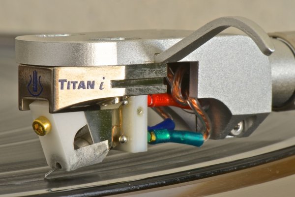

have a Lyra Titan i that served my well for a few years.....suddenly a few weaks ago I got some funny fizzy sound i LCH and after a while no sound i LCH....thought it was my riaa and after tube rolling and arm assy/cart swap, I found it to be ok
some days later fizzy LCH sound again and it went dead and has been ever since
took the risk of measuring with a DMM across the outputs and both CH measures 5R6
how is this possible...wire off before coils?
worth fixing?

They may fix it for free. A wire off isn't a normal wear and tear thing usually. I'd send it in via your in country distributor/dealer...It also qualifies for a trade in credit as is to another model. I've owned a Skala and Atlas, Lyra makes great cartridges...

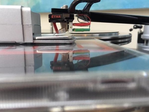

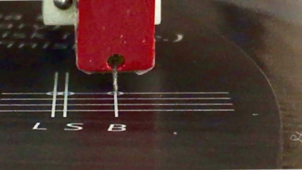

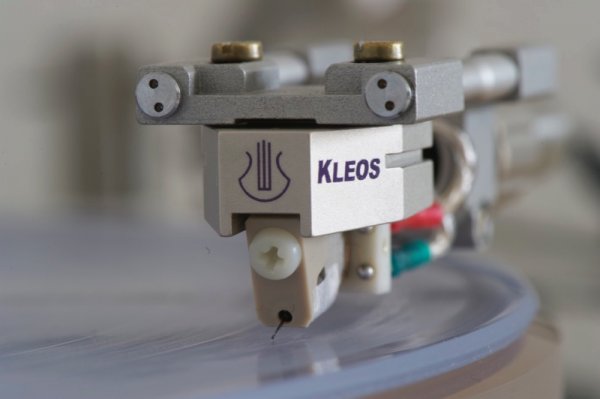

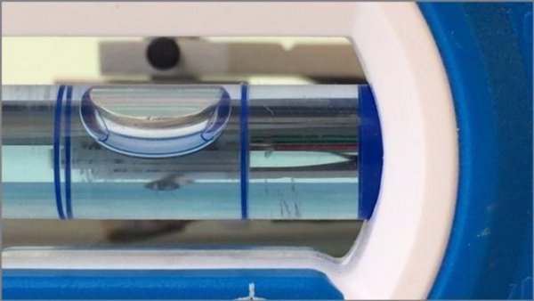

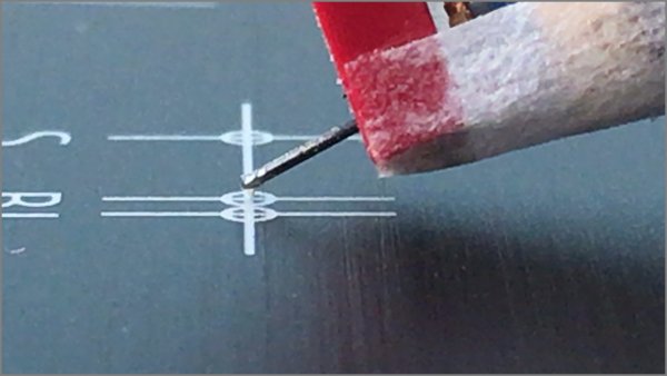

I just completed the installation of my new Lyra Etna SL and couldn't believe the improvement in SQ after fine-tuning all the usual parameters. I used the Dr. Feickert Alignment gauge for overhang, the Fozgometer for azimuth and an digital stylus gauge for VTF. I set the VTA at parallel aligning the top of the cartridge with a bubble level (picture is of a Lyra Kleos). The key to the improvement was the "discovery" of a free magnification app on my iPhone that lets me see exactly where the stylus tip sits on the Dr. Feickert grid (don't have a USB microscope). Up until now, I've always eyeballed it and not very accurately at that. The app is called Magnifying Glass HD FYI and it allows one to take a picture at the same time. Another subject which has previously been discussed is that the actual VTF can vary widely depending on where the scale's platform is placed relative to the record/platter (i.e. higher or lower than the record). For my measurements, I used a common size record on the platter and placed the VTF gauge propped up with CDs/cards so that the gauge's platform is at exactly the same height as that of the record. Obviously this arrangement places the gauge above the plinth but right next to the record.
Cheers!
