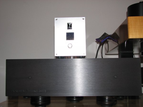

If you get the ET SUT you must get the cable that accompanies it in tandem--part of the designers synergy
It is the finest SUT ever made--put's the rest behind it

I prefer the Expressive with the Dynavector XV-1s that I have. But the Kondo I use with the IO-M and that combo is a must. The Expressive just adds so much life to the music and I haven't heard another transformer do the same.
