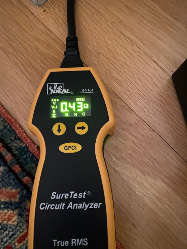

Phase:
Leakage to ground - 0.6V:

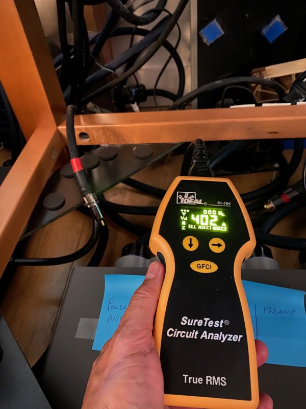

Next, measuring Audio Line1 again after 10 minutes or so. Significant drop, not sure what caused it, A/C was not running, but could be the fridge nearby :
Power capacity in Audio Line1, ASCC1 and ASCC2 tests - TAKE 2 :

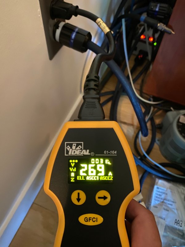

Next, the effect of the Shunyata Denali v2 + Venom power cords:
Audio Line2, Denali v2 IN:
Denali v2 OUT:
This clearly shows the max current draw out of the Denali is LOWER than what's coming in

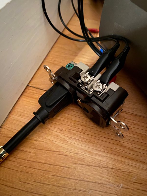

Measuring the Furutech GTX-D
The next investigation involved understanding why the two Audio Outlets consistently show lower current draws, even when few things are on it - like the preamp, phono preamp and tuner
The suspicion turned to those in-wall Furutech GTX-Ds. All others around them, which consistently get much higher readings, are high quality Leviton, and one of them gets me over 980A. So I decided to chain a spare GTX-D to one of the live GTX-Ds and measure peak amperage and impedance, using alligator clips and two per side in order to get 12awg on each leg.
It was a surprise, but the famed Furutech appears to be audiophile jewelry, a piece of crap, in the same category as those Ching Cheng cords I tested before, giving me basically half the current of the in-wall GTX-D.
So now we have all Leviton outlets around the audio system giving out 1.5X to 2X the current of the in-wall GTX-D, and then a chained GTX-D dropping half of its parent's as well, with much higher impedance than anything else I have measured (which is typically <0.15Ohms everywhere)
Needless to say, they will be promptly replaced with Hubbell

The eagle-eyed will notice two things: the chained Furutech outlet under test has no ground, and I posted peak amperage of the ASCC2 test which includes Ground impedance as well. That would seem like an error, but both ASCC1 and ASCC2 showed the exact same amperage, and after looking at the formulas again, they do compute to virtually the same thing when Ground Z is infinite; see this again:
