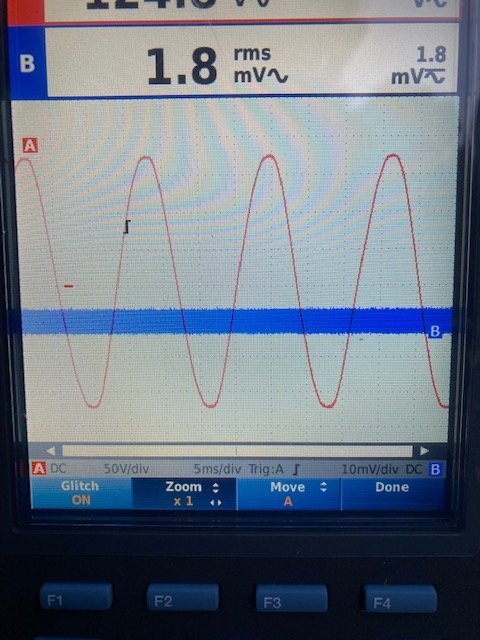

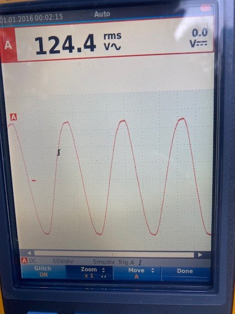

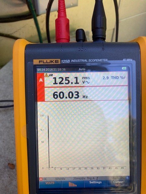

Rex has been very helpful to me in cleaning up some of the connections in my Mains Panel and advice on getting a more solid ground connection.
Interestingly, as I was in the process of reconnecting the ground, I took a listen to my system with the ground completely disconnected and then re-connected (with resistance of 14 ohms). The Audio was Identical un connected and connected. Go figure. I suppose the effect of the grounding can vary from system to system. And this was after I spent a full week burying ground rods under thousands of lbs of Bentonite clay (a couple of years ago). But even if, as in my case, the ground doesn't seem to effect the audio, it's of course good to have a correct safety earth ground.
I also rented out Rex's Fluke scope. It's a nice device with an excellent large screen readout. Pics below of voltage waveforms and harmonics. The waveform that looks the most even at the peaks was taken around 6 am. The other is typical all through the day. I also shut off every circuit breaker in the house and separate listening room one by one to see if anything would effect the waveform, but it stayed steady, so apparently nothing here is having an adverse effect on power quality. (if I'm interpreting this correctly).
