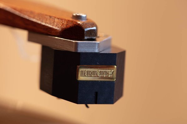

the new Miyajima Infinity Mono landed today, been listening for the last 2 hours. it's a big mother, for sure. but big does not mean lacking sophistication or 'touch'. the initial impressions are that i'm mainlining the musical flow. it is so direct and holographic, with a reach out and touch it presentation. big, bold, and sassy. but nothing rounded or thick with this one. not any sort of sense of adding heft but missing detail. this one has all the detail and nuance, ease and delicacy too. and tone, tone, tone. you feel enveloped by musical presence.
the Infinity is alive and life-like, such musical tension and energy. explosive. immediate. unrestrained.
http://www.miyajima-lab.com/e-mono.html
it's mounted on the NVS on my standard 12" Durand Telos with the wood arm wand, tracking at 3.5 grams, level in the back, plugged into the dart phono. i can also use the CS Port 63db input, or one of my EMIA Ag SUT's as the tonearm cable with reach all three choices. eventually i will try all three.
this one happens to be the 0.7 mil stylus version Infinity, which while brand new, is a loaner until my 1.0 mil stylus Infinity arrives in about a month. thank you to Robin Wyatt (USA Miyajima distributor http://www.robyattaudio.com/ ) for being so understanding and allowing me to use this for now. this one is said to be more 'stereo cutter head' friendly compared to the 1.0 mil. the 1.0 mil might favor older (prior to 65') mono pressings. at this point i can't comment on that, other than everything i've played so far sets the new 'mono' performance standard to my ears.
