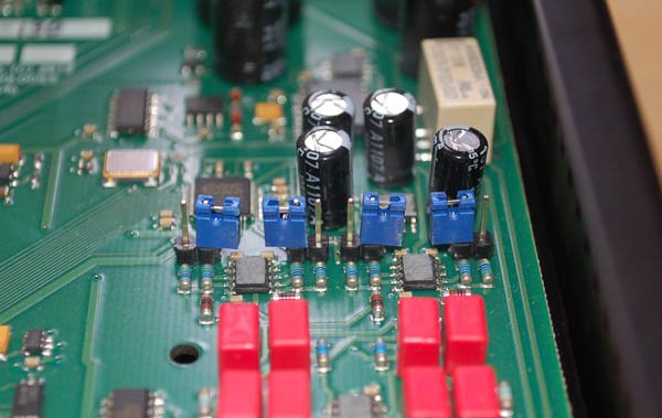

I am having some difficulties to tame some midrange ringing on some tracks, it doesn't matter from what source it looks that the Mytek overloads some time in the mid-hi section and rings...I tried with unbalanced cables and got almost the same issue.
mine overloaded the Electrocompaniets linestage due to a similar ringing. fortunately the EC has a gain switch to drop it 6db and the problem was solved. There are internal jumpers in the Mytek to pad the outputs 6db, its not mentioned anywhere in the manual that i could find but it was written about in mike lavorgna's review. Im gonna experiment with dropping the gain of my unit to improve the volume range of my amp.

Rob, is this picture showing the actual pin set to lower it 6dB?
out of the box its supposedly set at the higher gain. i havent opened mine up yet to see if the jumper positions match the pic or not. you can email Michal (the designer) at mj@mytekdigital.com

I just got my preamp back from servicing, instruments are better placed now (as expected) so integration and linearity - but still it overloads with some specific tracks, I will decrease the sensitivity as per Puroagave´s recommendation.

the chassis screws on mine must be loctited - tried every trick short of striping the screw heads - back to Michal it goes. mine really needs the pad, the linestage in the krell im now using can handle it, but the gain is much greater than any line-level component in the system and i want the preamp sec in the krell to do more of the heavy lifting. besides that, its sounding really good so far and padding the gain might help the trebble uneveness im hearing. comparo with the BADA is forthcoming.
Interesting. Since the gain is supposed to be user adjustable, you wouln't think they would locktite the chassis screws. I don't have any issues with gain being too high, but then I'm using a Krell KRC-HR preamp.
