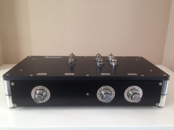

Can anyone tell me how to interpret the display of the v3 phono stage? I am auditioning a used unit without a manual, and the display readout is x.xx, so I don't know how to interpret a loading of, e.g. 420 ohms or 500 ohms.
I am using a Benz LPS cartridge. My current Einstein phono stage, run "wide open" has a resistance of 470 ohms, or 940 in balanced mode (from the Einstein manual.)
I tried initially running the Doshi with the display reading 4.70, then 5.00 (which sounded a wee-bit better). I just wish I could interpret the readout accurately.

This is the readout, I think this may be an early version of the v3 cosmetics. I've seen other pictures that don't have the decimal point. Should this be interpreted as 251 ohms?

I don't think the loading goes down to 2.51 so the readout confuses me. On my first MC input I have it set to 270 for my Clearaudio Goldfinger Statement. No decimal point. If I move it to MM it says 47.0.

The photo on the Doshi website does not show the decimal point, so there must be some change to the display on the newest v3 units.
Now you, like myself, are confused about how to interpret the display.
From the website:
With MC cartridges, loading can be varied from 10 to 250 Ohms in 10 Ohm steps and from 250 to 6K Ohms in 20 Ohm steps. Two loading options can be stored and toggled to allow instantaneous comparison, thereby facilitating fine-tuning of any MC cartridge. Two MM inputs—47 kOhms and 10 kOhms—are also provided.
I did cycle through the inputs, and remember seeing the 47 but don't recall the location of the decimal point. I am going to take a few pictures of the range of values on the display, see if anything can be interpreted, including looking to see where (if) the values change how much they increment. It will at least give an idea of where 250 Ohms is.

OK, problem solved... I just needed to continue to decriment the values, the display lost the decimal point and continued down to 10, so now I can set at 480 with some confidence that gets me 480 Ohms.
